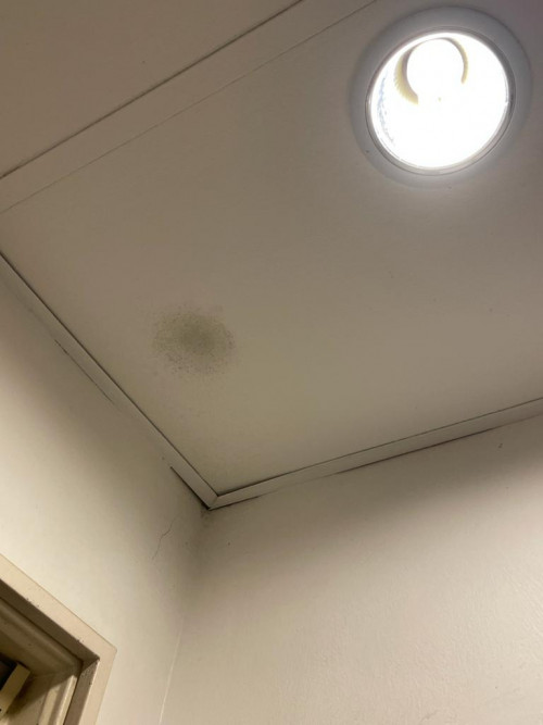

Update:

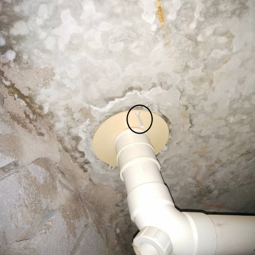

Photo taken by unit below. Pipe leaking or floor?

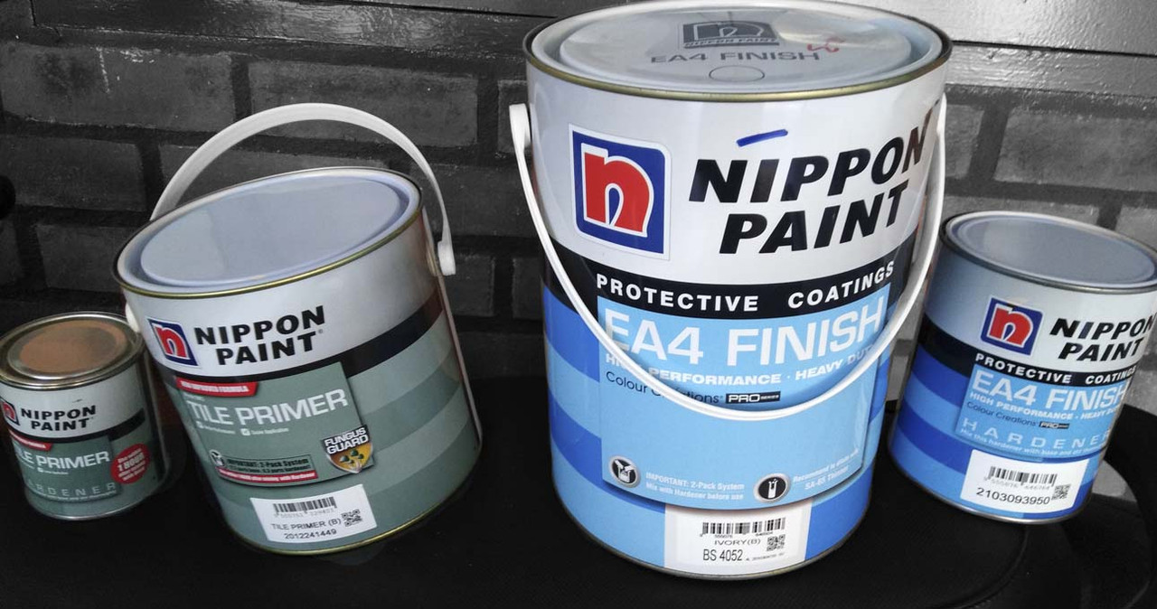

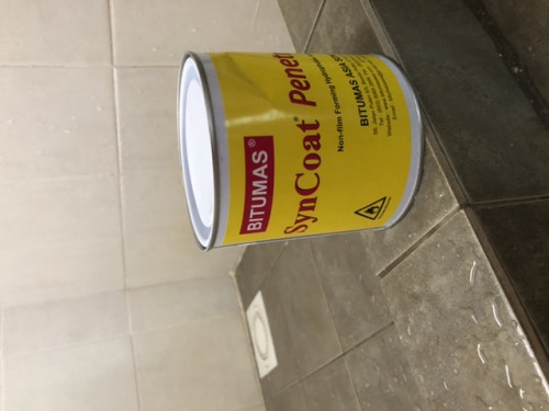

Base on /k suggestion, I try to source for sika. At the end, the seller recommend me this.
Solvent based. I sudah sapu the grout on floor and wall. Going to observe the result.

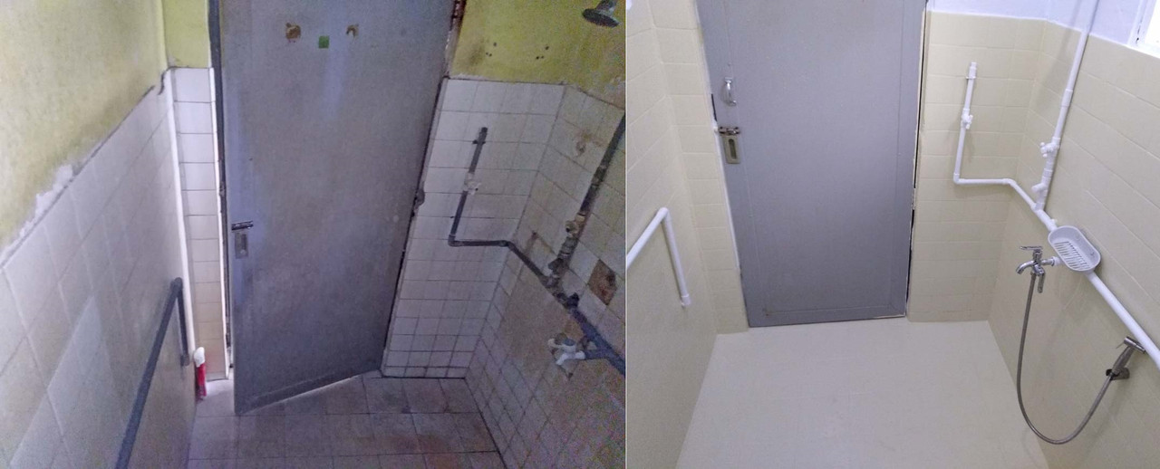

I used epoxy + glass flake combo.
Very easy to diy.
You have choice to maintain color of your existing floor tile by using clear epoxy.
Or change the color completely to your choice.
Did the coating for 3 layers and still good until now for more than 8 years already.
Spent around 1K total for 2 bathrooms (decent size bathroom)
Another pro is that it took total around 48 hours to fully cured for the whole 3 coatings.

Epoxy is ok only if its leaking thru the tiles.
If other leak root cause (from pipe in wall) it will not resolve the issue.

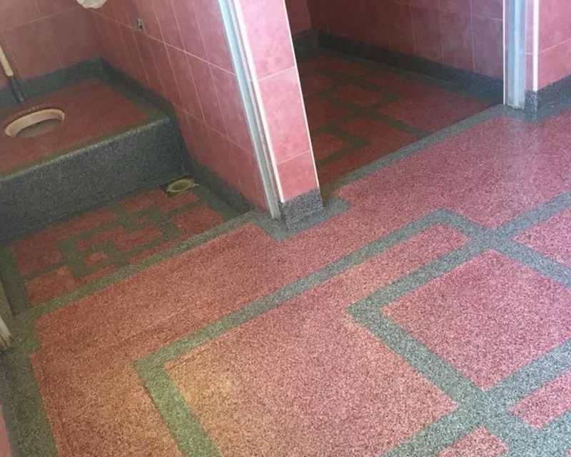

To do it nicely, better to hire someone familiar doing it or has done it or has seen it done by professional before to learn their tricks of doing it.
But for a nstural handyman, a youtube learning can also help to build confidence for DIY project.
Not realy high specs, a standard specs I suppose in order to create anti slip feel of the surface. The flakes will make the texture a bit rougher once you spread over the epoxy after 2 layer.
3rd layer is just to make the glass flake covered properly.

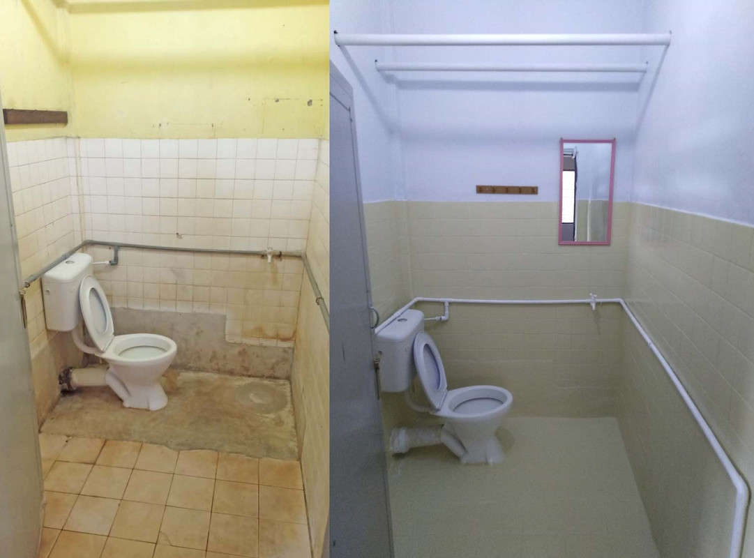

filler from mr DIY less than rm10
epoxy paint rm373
used 2L for 2layer
This post has been edited by croydon: Apr 12 2021, 11:01 AM

Glass flakes are sold separately.
You can buy from lazada or shoppee.
I bought from AE Multicoat (company).
The flake is spread over the epoxy coating while curing and evenly spread using brush to ensure smooth spread.
Dont hesitate to use generously as the texture is really worth it.
I do not have picture of it since it was 8 years back.
Anyway, try google it and you will find some good examples.
