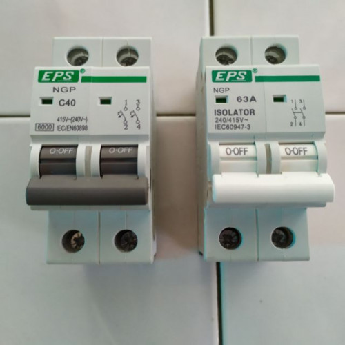

Would it help u to verify for me if i take both pictures of old and new MCB ?

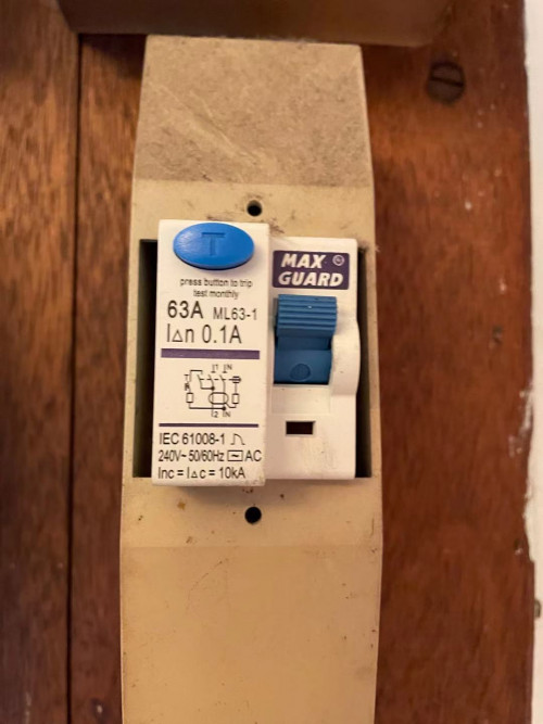

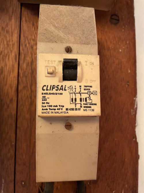

Right now after changing to the new one, tested out so far no trip at all
Below pictures for your reference
OLD MCB
NEW MCB

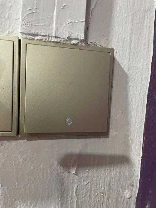

The A/C Switch that caused the tripping when on, all 3 rooms different switch design, i doubt that's relevant tho so only took one.
This post has been edited by Sotsotzaii: Mar 25 2021, 12:34 PM

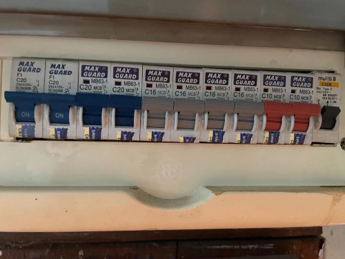

In the DB box should also have many many small MCB looking like this:
If the AC connected to C20 type then it should be OK. If connected on C6/C10 MCB those circuit not suitable for aircon.
From the wood base DB it is also about time for a complete overhaul of the DB box due to old age liao.
This post has been edited by ceo684: Mar 25 2021, 12:50 PM

Is this the one ?

The guy changed the ELCB from 40A to 63A
This post has been edited by yongtjunkit: Mar 25 2021, 02:17 PM

The guy swapped the ELCB from 40A to 63A

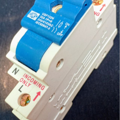

This is the MCB
So did he switch the ELCB to the correct / matching one ? So far no trip though when I turn on my a/c switch.

Look at the main switch, is the Amp(A) matching with the ELCB
I'm assuming it's the whole house trip
Maybe take a picture of it as well,, looks like this
Or this
This post has been edited by yongtjunkit: Mar 25 2021, 02:46 PM

That Main CB if tripped will cause no power to whole house. If only 3 room have no power in 13A sockets, then it was due to that small MCB. The C20 is the 20A MCB, etc.
That 63A is Main CB which supply power to all that small MCBs.
