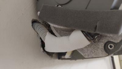

mine is York aircond ...very seldom use it ..1 day turn on the air-cond ..the water dropping like waterfall ...from behind of the indoor unit ...
dont know how to open it .. update... open and check the aircond as per photo.. This post has been edited by sgpdsmss: May 14 2022, 10:01 PM Attached thumbnail(s) |

QUOTE(sgpdsmss @ Mar 3 2021, 08:18 AM) mine is York aircond ...very seldom use it ..1 day turn on the air-cond ..the water dropping like waterfall ...from behind of the indoor unit ... Is the cooling coil and filter on IDU all clogged with dust? Try vacuuming out the dust first.dont know how to open it .. |

QUOTE(sgpdsmss @ Mar 3 2021, 01:42 PM) Youtube should have sth regarding ur aircon model on how to open it up to get to the drain pipe It maybe too cold temp n fan too slow issue Try set 25C and max fan see if drip or not. This post has been edited by ceo684: Mar 3 2021, 01:46 PM |
