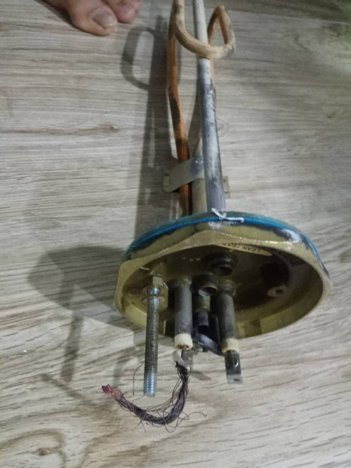

This is the element I changed during the last service..paid rm150. for that part..wink.gif
