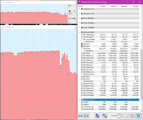

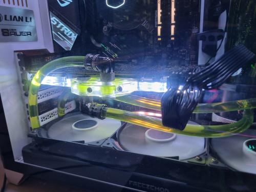

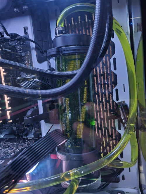

the item arrived and i installed it..somewhat.
forgot the pump bracket - so i cable tie it first.
the temperature is high, not what i've expected.
maybe
-i put the 360mm radiator bottom,3 fans blow out - i can switch those to intake.
-no intake fans (for now) i can install 3 fan at the side to be intake.
- i f-ed up the thermal pads / paste on the GPU block.

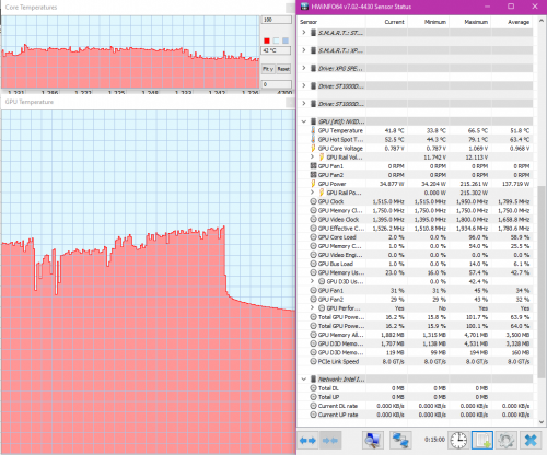

image below after one round of PUBG
GPU
Reservoir + Pump

QUOTE(aizielectreon @ Apr 12 2022, 09:09 PM)
Your temperature is indeed high
My 2080 Ti only runs at 48°C max on full load. And that's without airconditioner
If I turn on the airconditioner, it can go to as low as 38°C on full load while gaming. Airconditioner set to run at 16°C LOL
I think there are 2 possibilities that might cause your issue
1. Yes, you definitely screwed up the fan installation, you can't have all fans inside the case to be exhaust only. You need intake fans too. You don't have to install extra 3 fans on the side, just convert the bottom fans to intake fans
2. Yeah, you probably screwed up the thermal paste application, but it's quite easy to identify this. Since you're using soft tube, just unscrew the waterblock then see if the thermal paste spread evenly on the GPU die
By the way, what coolant are you using in that loop? I hope you're not using car coolant. That stuff will screw up your liquid cooling system sweat.gif

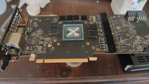

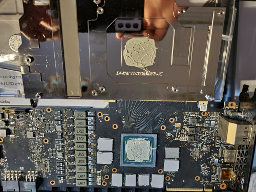

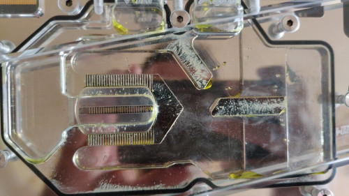

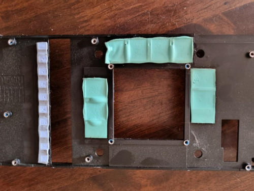

I ady flush them lmao.still can recycle the coolant right haha.heres the image
One of the vram has a different thermal pad, but same2 thickness.
Too add, i use the x method.
This post has been edited by aizielectreon: Apr 12 2022, 10:27 PM

QUOTE(aizielectreon @ Apr 12 2022, 10:26 PM)
SNIP
Hmm, the GPU thermal paste spreads fine
So it's definitely the fans layout then
Just remember to apply a new layer of themal paste
Owh and by the way, try to tilt your case left, right, front and back to make all the bubbles inside the radiator & the waterblock go into the reservoir. Make sure to run the pump at full sppeed while you do the tilting
Bubbles can also slightly raise the temperature but shouldnt be that high
My 2080 Ti should run hotter than your 2080 so something is definitely not right

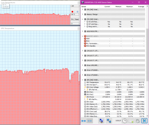

hmmm..the thermal issue still persist..
i give up laa

QUOTE(aizielectreon @ Apr 12 2022, 11:55 PM)
Well, it's cooler than before, but not good enough
The other stuff that I can think off that may cause your RTX 2080 to run hotter than my 2080 Ti are:
1. The coolant
2. The fan
3. The thermal paste
4. Fan filter
The coolant:
The Bykski coolant is probably not good enough in absorbing the heat from the waterblock and transferring it to the radiator
Hence why I only stick with EKWB CryoFuel coolant
Had bad experience with Corsair HL5 & Thermaltake C1000
Both of them cause the loop to turn muddy in less than a month
Had to try them out because EKWB CryoFuel was out of stock and there's only 1 seller in Malaysia who sells them at reasonable price
Waited for several months for the EKWB CryoFuel to be restocked during the MCO era hence why I decided to try those 2 coolants
Oh and I only use the clear transparent coolant, no colors
The fan:
In the market there are 2 types of fan. Airflow fan & Static Pressure fans
Airflow fans are to get air to move in and out of the case without any heatsink/radiator behind or in front of the fans
Static Pressure fans are made to be used on radiator & heatsink
I'm using Arctic P12 PWM PST CO. It's one of the cheapest high static pressure fan with dual ball bearings
What fan are you using?
The thermal paste:
The best thermal paste are the ones with high conductivity
Currently I'm using Thermal Grizzly Kryonaut
Fan filter
Are you using the top fan filter on the top of your O11? If yes, just remove it
You only need to use fan filter on intake, not exhaust
This post has been edited by sHawTY: Apr 13 2022, 07:29 AM

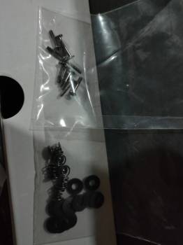

just want to check.
the screw mounting for the GPU Block, theres two type. one with the spring tension, another one is slim half thread.
i used all the screw with spring tension. am i wrong?
sHawTY
post Apr 14 2022, 10:07 AM
Frequent Reporter
14,909 posts
Joined: Jul 2005
QUOTE(aizielectreon @ Apr 14 2022, 05:45 AM)
No
