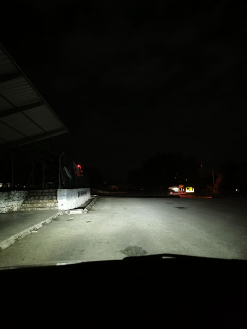

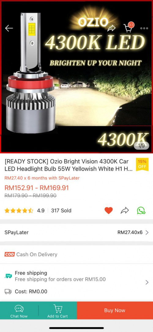

Hey guys, thought I should provide an update here. In the end I decided to just buy 4300k LEDs because full retrofit is just too expensive for me haha. Looked online and decided to buy this after seeing the reviews seems ok:
The end result?
I must say WOW definitely much brighter than my old regular bulbs and so far no glaring issues. Not sure how would it compare to those full LED and projector retrofits that costs RM2k though. Nevertheless still very happy as the price is quite cheap and can already satisfied my needs. So far already using almost 6 months and very happy with it biggrin.gif thumbup.gif
