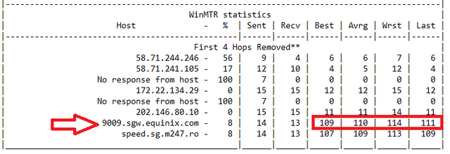

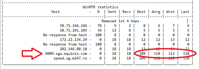

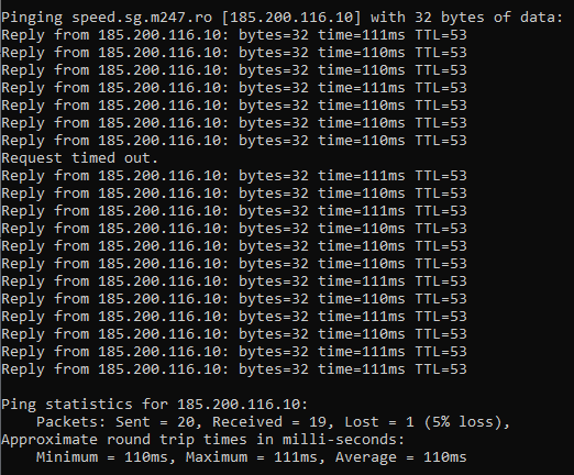

Please take note that Maxis network is experiencing very high latency to Equinix SG servers.
The servers are getting choked to a point that from Ipoh to Singapore latency is registering over 100ms.
Posted a trace chart as proof. As soon as the hop reaches 9009.sgw.equinix.sg, the latency shoots up to over 100ms.
Can you do something about it Maxis?

what really is the root cause for this issue?

Could be 2 reasons which I can think of.
FYI Maxis as peering arrangements with Equinix but it seems M247 is not prioritizing packets which are reaching from Maxis as seen in the screenshot where the hop just right before 9009.sgw.equinix.com is as low as only 11ms belongs to Maxis Broadband (202.146.80.x)
Either Maxis doesn't want to increase their upstream link to cope with the traffic surge, Equinix doesn't want to grant them more bandwidth by not honoring their peering arranegements.
Apart from that everything seems resolved from last Wed's national backbone incident.

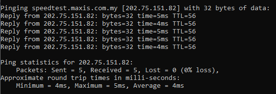

Better than before. Now ping from Ipoh to Maxis's Speedtest server can reach as low as 4ms even at 9PM (05/02/21)

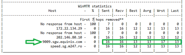

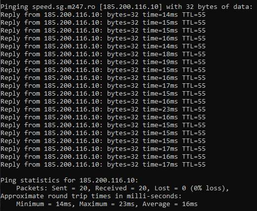

Thank you to those involved for resolving this issue.
Latency spike issue to M247 Singapore is already resolved.
Average latency to M247 is now 13ms.

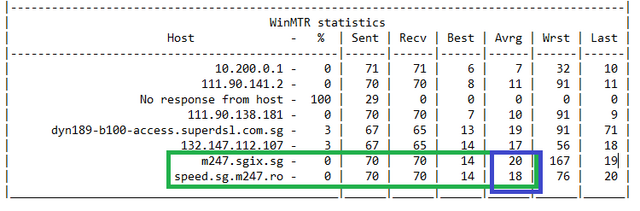

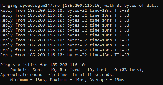

Pinging via Shinjiru (Using Time/GlobalTransit uplinks), I could maintained a steady 14ms ping to M247 Infra SG as below:
MTR results to M247 Infra SG(AS9009) via Shinjiru:

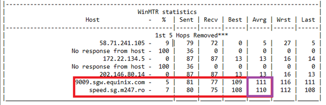

But at the same time when I use Maxis directly:
MTR results to M247 Infra SG(AS9009) via Maxis-Equinix SG:
Clearly as you can see Equinix is messing up your routes, Maxis. Please screw them real bad if you need to Maxis or better consider in long term getting rid of them in favor of SGIX which other Malaysian ISPs have already made that decision.

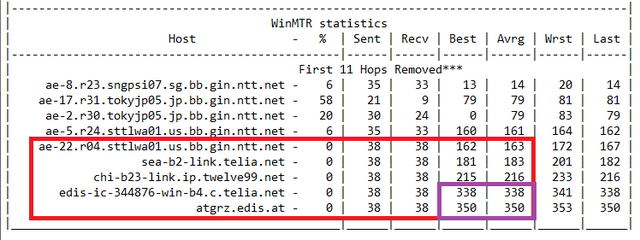

Why your Europe connectivity so jialat one?

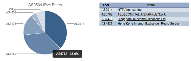

Other ISPs only need to cross 1 single continent , yours crosses 2 major oceans - Pacific Ocean and Atlantic Ocean the big way round earth to reach Continental Europe countries such as Switzerland, Austria, Luxembourg, Belgium and even Germany?
Is it because you got USELESS Telecom Italia Sparkle - SEABONE as your 2nd major upstream provider?
Should have dropped them in favor of TELIA and GTT instead. Why you continue to subscribe so much UPSTREAM capacity from them when they're PRACTICALLY USELESS?
AS6762 - Telecom Italia Sparkle

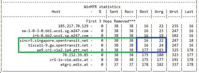

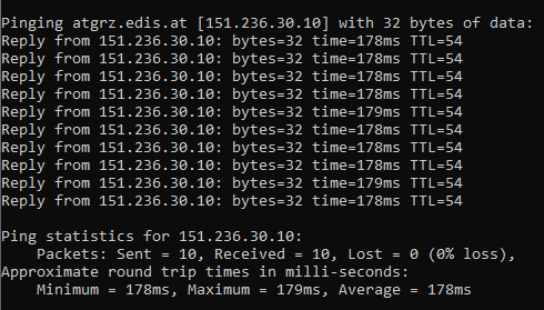

Just look how M247 Infra Singapore routes to major EU countries compared to yours:
Via M247 Infrastructure Singapore
Via MaxSucks and its USELESS T-BONE!!
How come ALMOST double? 180ms(M247 SG) vs 350ms (Maxsucks)
