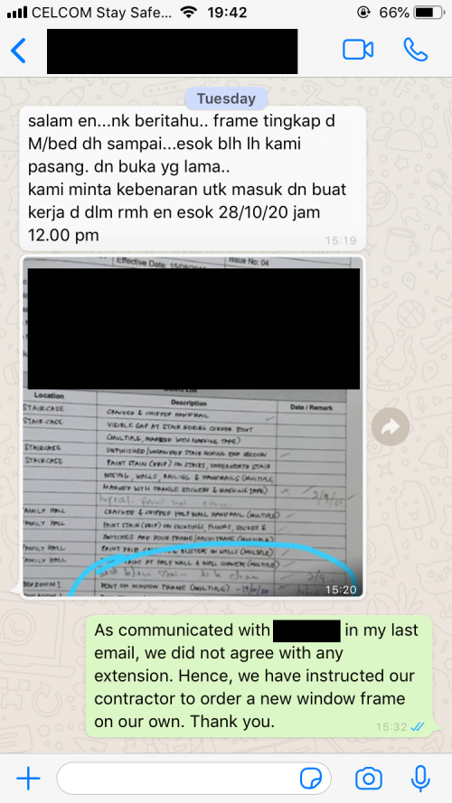

19th October 2020, Afternoon – I inform the developer, no more extension. Call contractor to measure window frame.
27th October 2020 – Developer contacted me to install new window frame, I said, no, I already ordered myself
30th October 2020 – Developer sent letter said everything has been completed. Consider the matter resolved.
