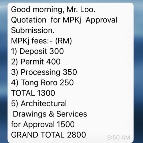

post Oct 21 2020, 09:19 PM
22 posts
Joined: Apr 2020
don't forget architect cost, and bribe cost.

QUOTE(BronzePlate @ Oct 21 2020, 09:19 PM)
I budgeted 5k for the renovation plan and approval.
