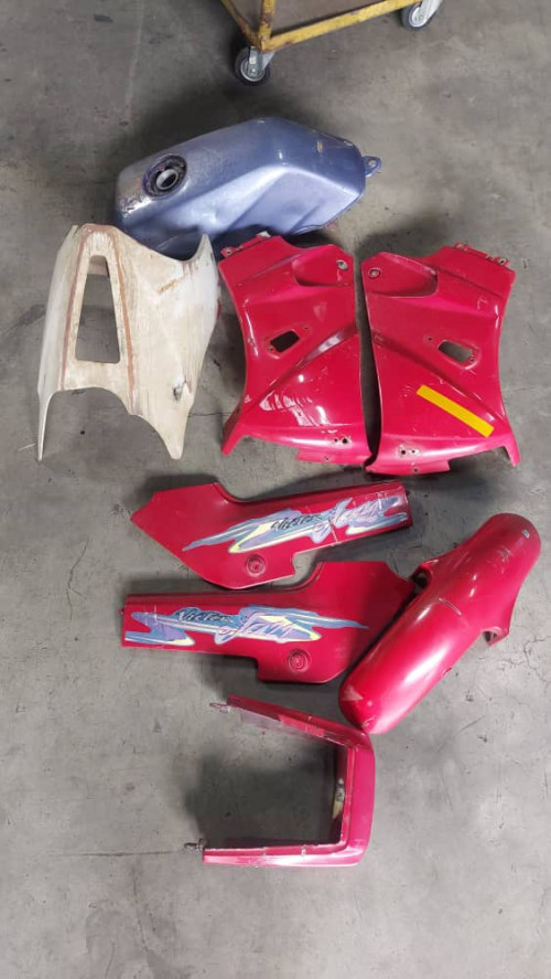

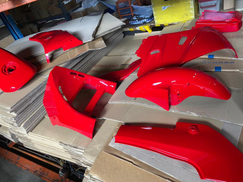

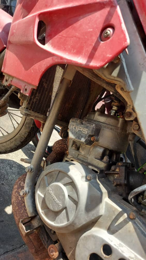

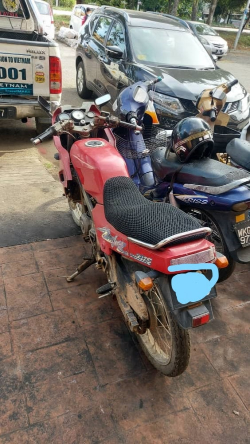

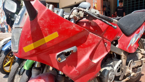

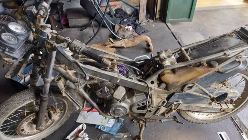

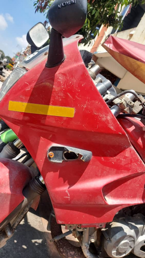

Right now I'm restoring a '92 Kawasaki Kips KR150B

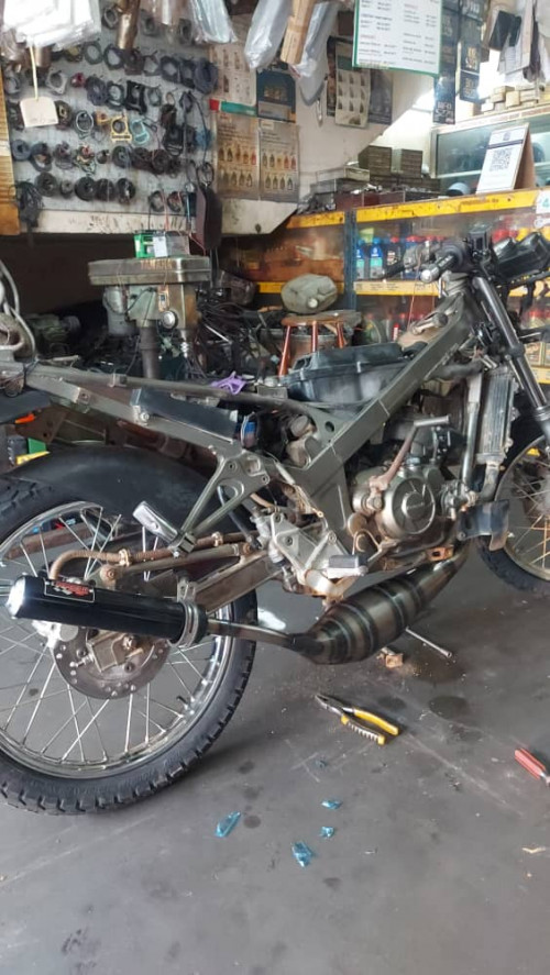

17/10 - Sent to workshop for initial service / repairs
20/10 - Visit workshop take the plastic + tangki back

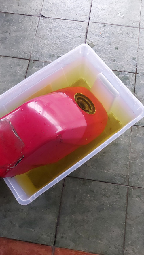

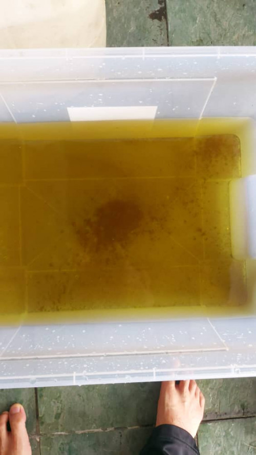

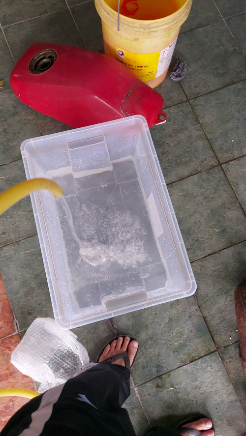

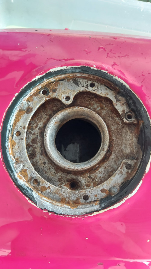

23/10 - Rust removal on the tangki

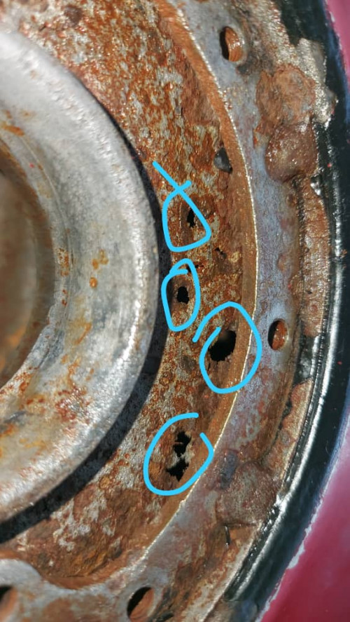

24/10 - Motor running, just left respray + fix tangki rust hole

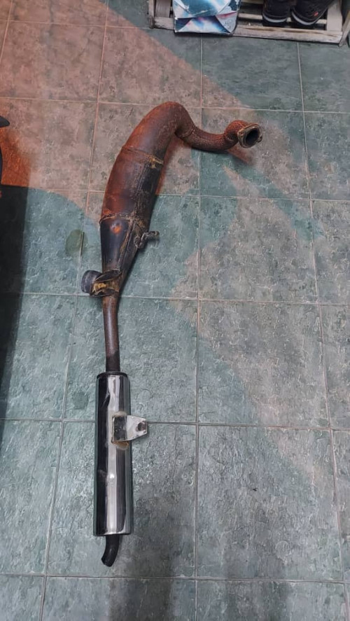

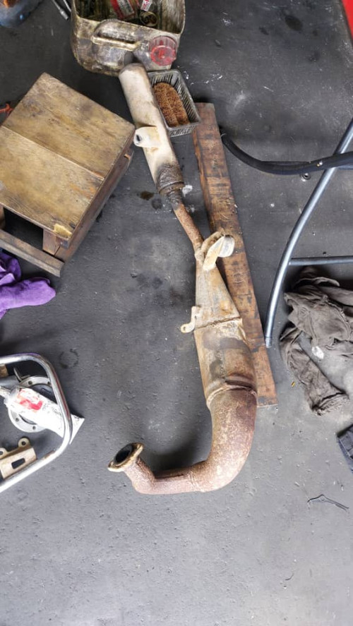

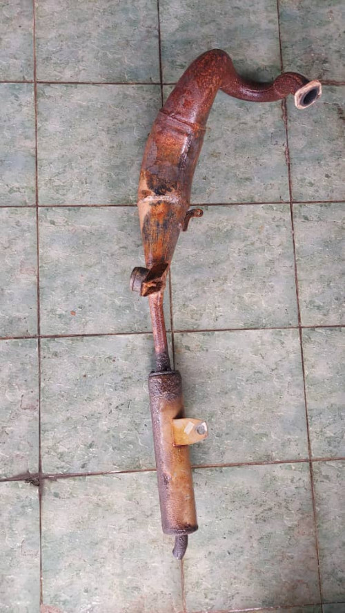

27/10 - New exhaust arrived
4/11 - Clean stock exhaust

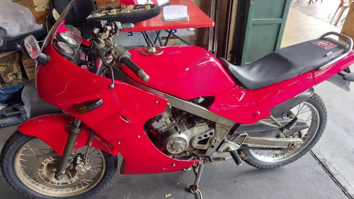

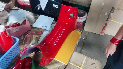

4/11 - Sent cover + tank respray red

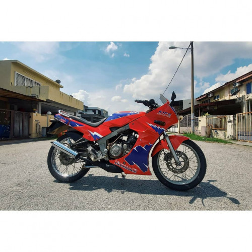

17/11 - Respray cover set + assembly cantikkkk
Final completed look

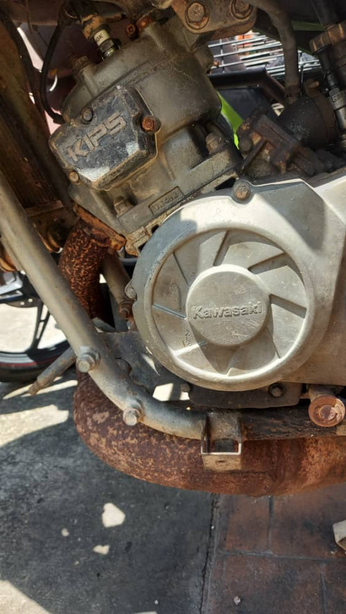

QUOTE(SourLemons @ Oct 17 2020, 05:04 PM)
just got this bike from uncle for free. I was only 2 years old when he bought this bike so I need some tips of maintenance
Right now I left it at workshop to restore it
1. There's no engine oil right? Need mix petrol with 2t oil together? What is the ratio? I need to do every refuel?
2. Other than that, what are the regular maintenance needed?
1. Got eo.
2. Need to flush the brake fluid, change pad, service the fork, service the carb n drain fuel tank (if long time never start), change air filter, change fuel filter (iinm got one )

Kawasaki Integrated Power Valve System
netmatrix
post Oct 17 2020, 05:53 PM
6,728 posts
From: Zion
This one not auto mix one meh? I remember it has its own 2T tank and you do not need to pre mix.

If got own 2T tank, need to check working or not. Otherwise no 2T flow to petrol can damage the engine

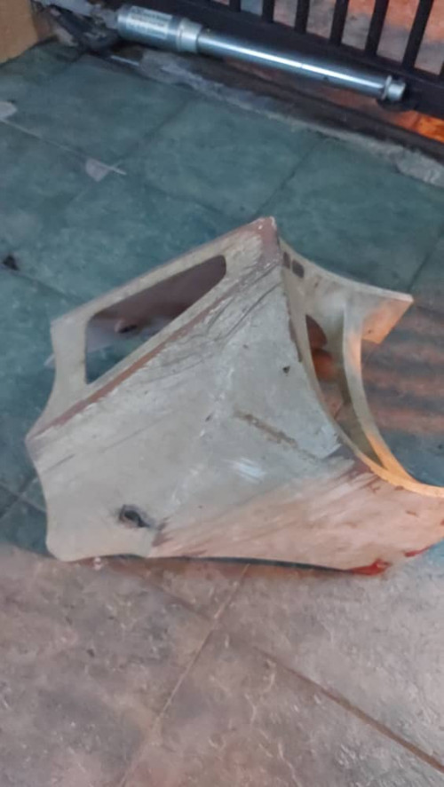

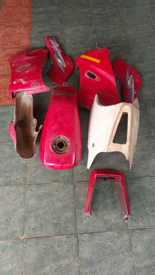

19/10 - Managed to find this plastic engine cover

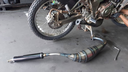

20/10 - Visit workshop take some parts back for cleaning and respray
that exhaust is a headache, not sure how to restore it back
