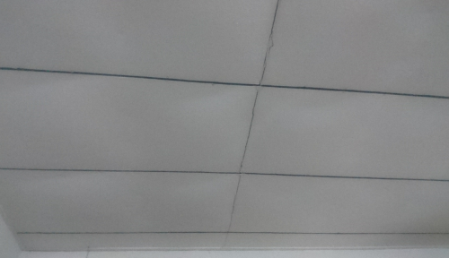

Fibre cement board or asbestos ni?

Dei itu gypsum fibre board la. Name pun plaster ceiling where got asbestos.

That looks like plaster ceiling.. no asbestos content.. asbestos only in old corrugated roof, that also if its broken or damaged. if still intact it will be no problem... facepalm ts. go gugle first la..

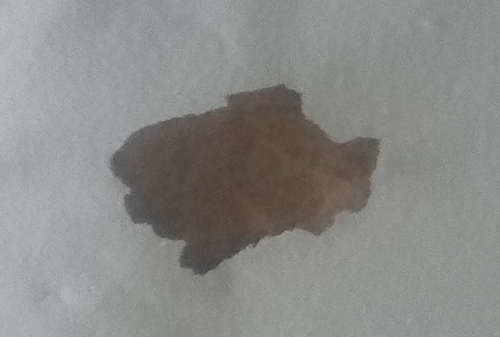

Plaster ceiling bro
I just opened the downlight and that is what I saw.

When I install partition wall, didn't see this which colour strands..so only gypsum board for ceiling have this strand..

It looks just like asbestos fibers..and this house is old..

How is the ceiling like? Piece by piece or flushed smooth?

Its soffit is flushed and smooth..maybe the contractor already smoothen with stopping compound.

I think u didn't notice the white coloured strands inside the board.
Plaster ceiling no worries man...

Ohh u mean the fibre?
Means that ur ceiling is fibreglass reinforced gypsum board, or contractor usually called it GFRG for ceiling.

I think it's fiberglass in the gypsum board. Saw it in Google..

I see...I suspect it's fiberglass..ya those grey kampung atap or those 2x4 or 4x4 house ceiling use asbestos...the house I grew up in use 2x4 asbestos..and only now I realised it.

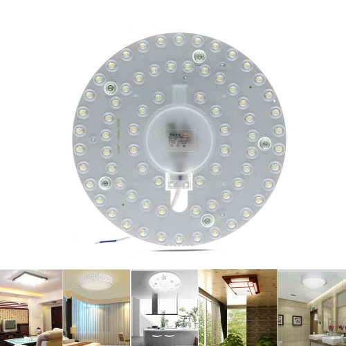

Aih.. This led setup. Mine 3 out of 10 gone already. So fast kaput.

its just glass fiber. long strands. if i were to choose, i would rather have bare ceiling than to deal with this glass fiberboard
sometimes i have to change the lamps and i have to suit up like entering covid ward.
asbestos is wooly. now most likely found in industrial pipes. the last thing to remove/change

Normally is overheating or driver problem...buy branded LED bro..e.g. phlips...don't buy buy elcheapo..

QUOTE(s@ni @ Aug 18 2020, 11:41 PM)
share my tips how to make it live longer:
open up the ballast/driver box, you will see a big capacitor. normally this capacitor is designed to sit on the chip that is hot.
the hot chip boils the cap, then your led start flicker and then gone.
so,
bend the capacitor 180 far far away from the chips.
avoid putting the driver on top of the led. this gets hot and cooks the capacitors.
ciplak led the weakness is at the driver
branded one the weakness is at the led.
so my rule of thumb is, if you want bright, go for ciplak. every 3 years change
no point buying expensive branded one, as the LED will get dimmer and dimmer although can last many years
if the place is hard to get to, eg high ceiling, dont use these build in type. get a screw bulb casing. you can then change the bulb with a extention rod to screw in.

Ya the ring type one very tahan..but I still changed to magnet/stick on 15w LED plate to save electricity.. it's comparably bright but hope it'll last..

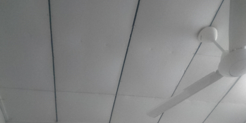

This is the ceiling from a very old house, can tell whether contains asbestos?
TSRootOfJesse
post Aug 27 2020, 05:16 PM
241 posts
Joined: May 2007
QUOTE(starry-starry @ Aug 27 2020, 05:14 PM)
This one very likely to have asbestos..those are the panels, 2 x 4...same as the old house I used to live in.
starry-starry
post Aug 27 2020, 05:27 PM
919 posts
Joined: Aug 2009
QUOTE(RootOfJesse @ Aug 27 2020, 05:16 PM)
Shit! The ceiling has cracked and got people came to check, they said looks like kertas only cuz it's very light. Does it mean everyone in the whole household has breathed in asbestos?
QUOTE(starry-starry @ Aug 27 2020, 05:27 PM)
QUOTE(bryon @ Aug 27 2020, 05:44 PM)
Officially banned but still a lot private housing buy asbestos to replace old ceiling as it's cheapest compared to other alternative
Just to share it's brown colour inside, very soft like texture like some kind of sponge soft board? Does it contain asbestos?

One of the persons who came actually made a hole to the ceiling to check the damage! Only realized dangers of asbestos later so kinda worry now.. Looking at photos I shared earlier, possible to have asbestos? How come few personnels I asked to come for inspection had no fear of asbestos ceiling even part of d ceiling was damaged? I even inquired how they r going to replace the ceiling, they don't seem to worry the risk of removing current ceilings..
