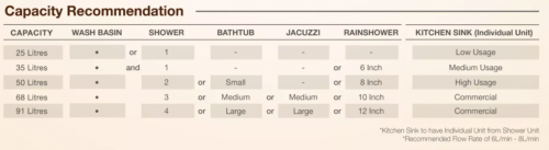

Hi Sifus, need advice please. I have 5 bathrooms upstairs (4 daily use bathroom for parents and children; + 1 guest bathroom). In terms of usage, there’s a high possibility that at least 2-3 persons will bath at the same time and possibly up to 4 pax at the same time
Can I get advise on 3 questions : (assuming no rain shower in any bathrooms)
1. I’m planning to get Joven storage water heater. Would it be better to get :
A) 91L to supply all 4+1 bathrooms
(am concerned that 91L would take too long to heat up and in the event of “malfunction” all bathrooms no hot water and costly to replace vs Option B)
OR
B) 68L to 3 daily usage bathrooms (rooms are next to each other) + 25 or 35L to 2 bathrooms (daily usage bathroom + guest bathroom)
2. Whichever the option, is there anything in particular I need look into in terms of wiring/switches?
Sorry if it’s a noob question, Is it possible to have 5 way switches to control one heater tank (option A – 91L) or 3+2way switches to control 2 tanks (option B 68L + 35L). Ie, each room has their own heater switch and turns on the heater when they need to shower. Any issues if 2 persons turns on the heater switch to the same heater tank?
3. Based on the preferred options, is there a difference to the number and HP of water pumps I need, or I just need 1 as usual, at the main water inlet right after the POE filter? What HP water pump should I get? (I’m presuming I’ll need water pump as I’m installing a storage heater tank, right?)
Thank you very much in advance for all advice

Hi all, I would like to get your advise regarding storage water heater. The purpose is only for shower for 3 bedroom. Initially to buy 80L but after ask from the seller, he told me ;
Not recommend 1 tank for 3 bathroom. Ususally 3 bathroom sharing 1 tank.
Is it correct? Will it add cost to the wiring & plumbing? Thank you so much!

It is not about the number of bathrooms u connect the storage water heater to, but the number of people showering in those 3 bathrooms at nearly the same time. Eg. if u have 3 bathrooms but maybe 2 of them very seldom u have people showering in them, then maybe it is enough.
Also, the further away the bathrooms are from the storage water heater, the longer distance the hot water has to travel, causing a lot of heat loss. Do bare that in mind if you are planning to install 1 heater for 3 bathroom, where the furthest bathroom might have generally colder water compared to the bathrooms closer to the storage water heater. And you have to be very careful where you plan to place the copper piping connection, since they are quite hot and might be dangerous for kids / pets if they are easily accessible (better to be hidden).

QUOTE(vernee26 @ May 21 2021, 09:56 PM)
How many people usually bath at the same time will make a difference in the "size" of the storage heater, not the number of storage heater, no?
As mentioned above, it is about 'the number of people using it at the same time' factor that we need to take into account when choosing the capacity (and if one is not enough, then multiple storage water heater), and not the 'the number of bathrooms' factor.
Something like this (look at the recommended number of users table):
And the other factor is the distance between the storage water heater to the bathroom (or bathrooms if the storage water heater is shared amongst few bathrooms). The shorter distance the better. Longer distance should cost more on the piping / hacking side + heat loss.
