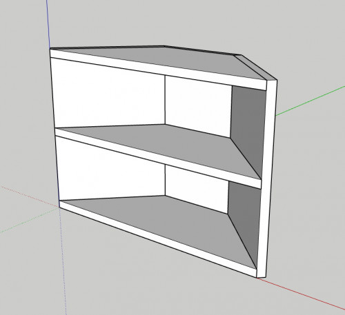

So sorry that I have lost the real photos, otherwise you would easily understand. Anyway, I have drawn a sample to show what I did.
user posted image Corner cabinet something like this
user posted image Can become flat pieces like this.
These planks are what I told the door shop I wanted, and then I worked the planks to the shape I needed for the cabinet. The door shop is used to making solid doors, so I figured they would be able to get me S4S pieces, and nice ones too. In my case it worked.
I use SketchUp to design everything first, because damn, wood is expensive!

QUOTE(stormer.lyn @ Jun 5 2020, 01:54 PM)
just buy some 15 /18mm plywood and edge band it or wood strip glue and nail gun.
you didnt put down the dimension is very hard to judge.
but it seems that you need to buy a couple of 1x4 or 1x6 to glue them up and cut.
What I would suggest is that if you don't mind finger joint you can buy rubberwood panels AB or BC grade or pine wood panel 4x8 about 200 or below.
