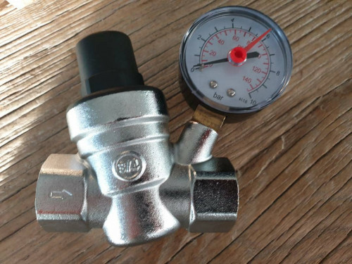

Hi guys, my home current keep having this water hammering issue which i believe is due to high pressure from municipal water supply. This occur especially during late night where water usage for the city is low. And i found out my shower tap is leaking from stem and i believe this may be the cause.
Anyone can let me know where can i get this water pressure regulator? I searched at lazada and i not sure is this the thing for my case. I need something tat will maintain the set pressure main supply water pressure. Attached Image

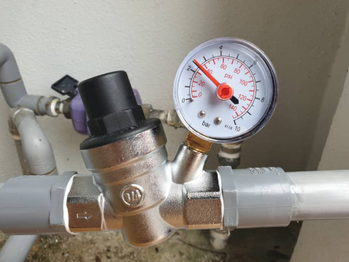

Yes those pics you have are correct. Just that some have an added water pressure gauge and some doesn't. Better to get the ones with the water pressure gauge that way you can see if your suspicion is correct. Usual house water pressure is between 40 - 60 psi. Anything higher and you have a risk of internal water pipes bursting.
Usually installed at the main water pipe (right after your water meter). Make sure you get the correct pipe size ... usually identified either by DN20 / DN15 (different pipe diameter).

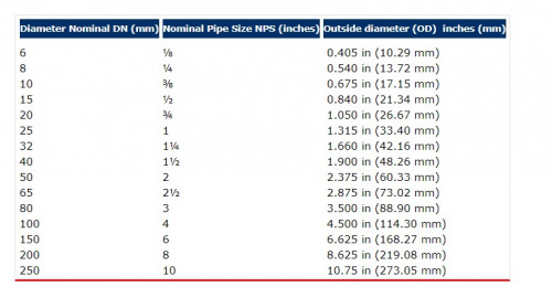

I have attached a table on the DN20 / DN15 measure for easier reference so you know what to buy

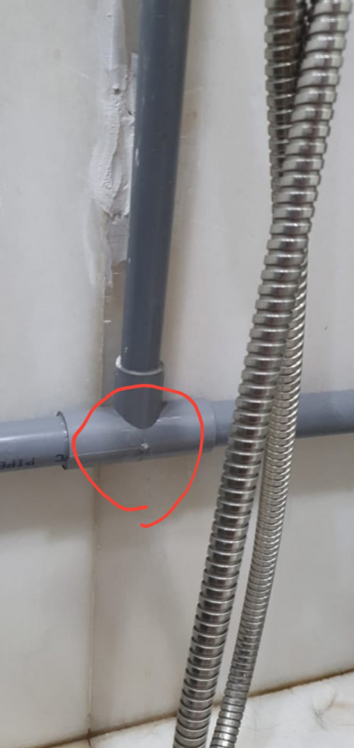

My sis house had the same issue in every 6 months sure will have water leakage at the pvc pipe joints or bidet hose bursting in the middle of the night due to high static pressure & the after effect of water hammering.
After installing the PRV after the meter, it did reduce the impact of water hammering & also able to reduce the static pressure when no water being flow/use. It's been almost a year & no more leakage or hose bursting.

This is what i been experiencing these years, i already redo whole unit piping and even after that the joint at bidet always burst every 6mo exactly. May i know how is your pressure valve working so far? Becos my apartment here during day time the pressure is just nice but after around 11pm then the pressure become crazy..idk if i install the pressure valve then my water will become very slow during day time or not

The pvc joint cracked cant see from photo, water will dripping from the crack.
The plumber just bring their own pipes, the pipe yes is approved according to the laser writing on it, but all the joint got no markings.
juzmafia
post Aug 28 2021, 12:54 AM
562 posts
Joined: Oct 2012
From: Out of the world...
QUOTE(WhiteFlag @ Aug 27 2021, 09:57 PM)
If it is cracked then probably not a good quality T-joint..
Good one should have some word/specs printed on it & it is thicker..
So far, never had cracked joint, only improperly glued t-joint connection and that was before i had PRV..
Maybe it help in your case..
mini orchard
post Aug 28 2021, 06:54 AM
10k Club
14,511 posts
Joined: Sep 2017
Off the main water supply and turn on the tap to drain the balance water. Wipe dry the T area and apply pvc glue around the leak area. Wait for an hour to completely dry and turn on the main. If it stills leak, then change the whole piping to stainless steel.
Sometimes a quality product can defect due to batch production problem or mishandling. If is a repeat, avoid buying a replacement from the same shop.
If is pressure problem, then all T or elbow joints would have the same problem. Your particular problem could be the area is without a pipe clip to hold the pipe and prevent 'vibration' when the pressure water passes through.

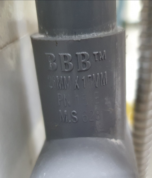

WhiteFlag
post Aug 28 2021, 12:26 PM
540 posts
Joined: Jan 2008
QUOTE(mini orchard @ Aug 28 2021, 06:54 AM)
I found that there is some wording on the broken tee joint, looks like legit brand but im not sure
