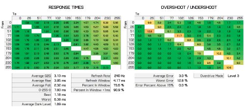

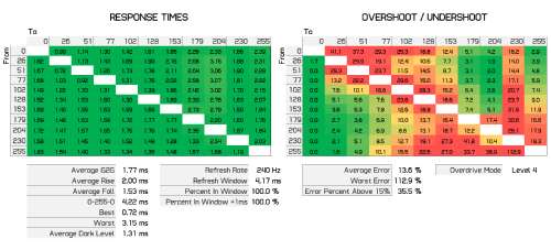

QUOTE(edministrator @ Mar 29 2020, 02:16 PM)
as many have mentioned, IPS do not have 1ms response time, and even if stated 1ms, it is sort of simulated/boosted artificially and gives you more image degradation than improving it. True 4ms is the best you can get for IPS currently.
not only IPS, TN also usually cannot hit 1ms response time, unless switching to absurd overdrive modes that introduce significant undershoot and overshoot. usually with the best overdrive settings TN panels can hit a maximum average of 3ms, but only on some of the best TN monitors out there, for example HP Omen X 27 which is very expensive (about 3k) in malaysia, especially for a TN monitor.
see chart
below is max overdrive
undershoot and overshoot introduce inverse ghosting and corona artifacts
This post has been edited by lolzcalvin: Mar 30 2020, 01:54 PM
