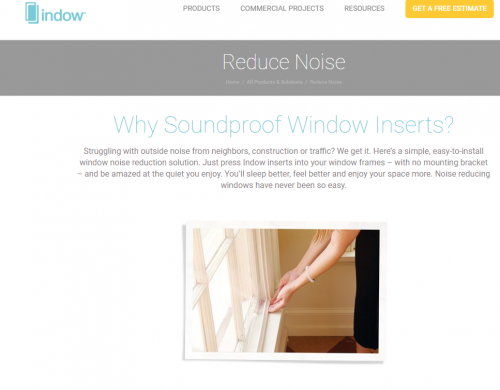

I am looking for more cost efficient windows inserts, to be placed over existing window frames for soundproofing/ noise reduction
Something like what is offered here https://indowwindows.com/solutions/window-noise-reduction/
Anyone knows a contact in Malaysia that can provide this?
