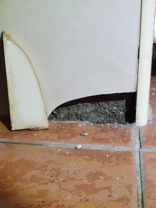

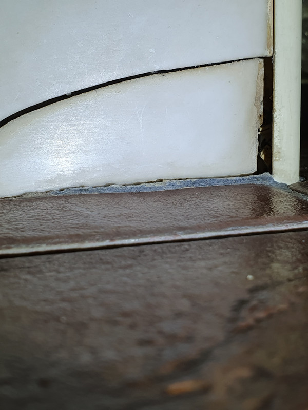

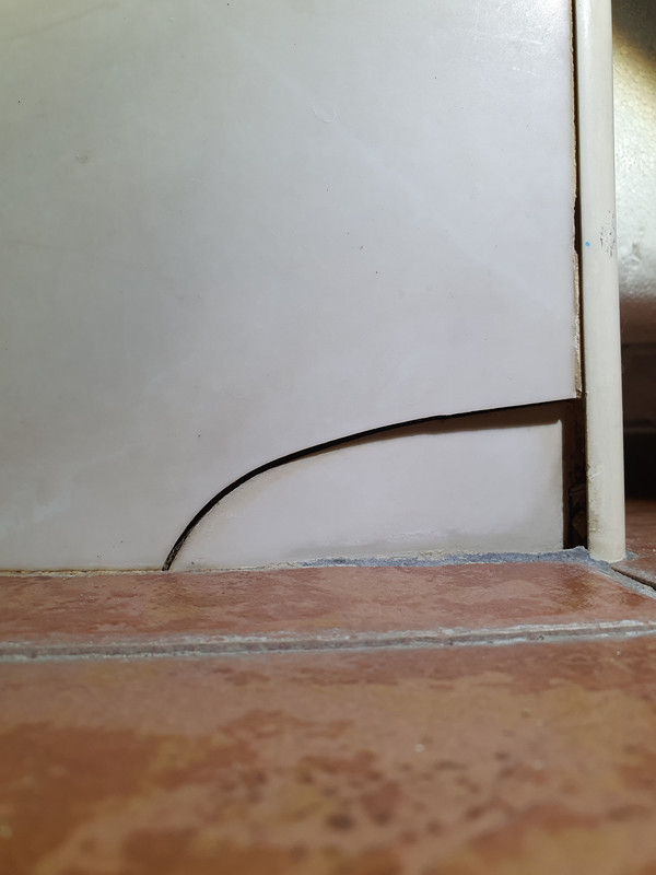

hi guys, have similar problem at yard / wet kitchen. how to take out this small piece of cracked tiles that goes in the wall? after that, which solution / chemical to fill up the hole / crack for the small piece of broken tiles?

QUOTE(#Victor @ Nov 8 2020, 04:03 PM) hi guys, have similar problem at yard / wet kitchen. how to take out this small piece of cracked tiles that goes in the wall? after that, which solution / chemical to fill up the hole / crack for the small piece of broken tiles? Use a small knife to tilt the tile outward and then remove slowly.![]() ![]() Remove old cement on wall using hammer and chisel. If there are some on the tiles, just leave it there, otherwise you may crack if further trying to remove it. Buy the cement for tiles at hardware shop. Loose 1kg pack is RM2. You need few packs Mixed with water until is paste form. Spray the affect area with some water to make it moist ...not too much water, otherwise the cement paste will not stick to the wall Plaster the cement paste on the affected wall and a thin layer on the tles. Put the tile back on the wall and use a wooden hammer holder to gently level the tile. Clean the tiles with a wet cloth for any excess cement. Use white powder filler paste to cover the crack line. This post has been edited by mini orchard: Nov 8 2020, 07:23 PM #Victor liked this post

QUOTE(mini orchard @ Nov 8 2020, 07:23 PM) Use a small knife to tilt the tile outward and then remove slowly. done tilted the broken piece tile out from the wall. now afraid to fix back as no experience with cement at all... how much cement should insert into the hole?Remove old cement on wall using hammer and chisel. If there are some on the tiles, just leave it there, otherwise you may crack if further trying to remove it. Buy the cement for tiles at hardware shop. Loose 1kg pack is RM2. You need few packs Mixed with water until is paste form. Spray the affect area with some water to make it moist ...not too much water, otherwise the cement paste will not stick to the wall Plaster the cement paste on the affected wall and a thin layer on the tles. Put the tile back on the wall and use a wooden hammer holder to gently level the tile. Clean the tiles with a wet cloth for any excess cement. Use white powder filler paste to cover the crack line. what do you mean plaster the cement paste? any tutorial video could share for reference? ![]() |

QUOTE(#Victor @ Nov 9 2020, 11:45 PM) done tilted the broken piece tile out from the wall. now afraid to fix back as no experience with cement at all... how much cement should insert into the hole? Fill the cement paste till the thickness of the tile and when you place it back, it sit almost evenly to the unbroken tile. Then use the wooden hammer holder to gently even it.what do you mean plaster the cement paste? any tutorial video could share for reference? ![]() |
