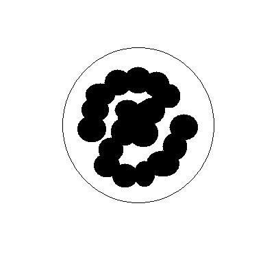

i did this design for my fren:
could run at 4Ghz...before could do 3.6Ghz but at temps of 70C. Now temps is idling at 44C anf 50C on load.
walla~ so u did it on what ey? can u gimme the size of the block u design there?

material is pure copper.....2" in diameter ( enough to cover the surface area on all Proc ). water channels are made using a bench drill and dremel tool kit to smoothen the drilled edges. the mounting braket is made of acrylic.

nope...no copyrights, u can use my design tongue.gif . I built this block specially for me fren since he complain PC hot and yet doesn't wanna buy a WC setup. I posted some pics here ( # post 172) :
http://forum.lowyat.net/topic/41021/+160
I use acrylic as mounting bracket and screws the secure it. My whole block is copper...yup, brazed the whole thing up. But make sure you have good brazing skills.
