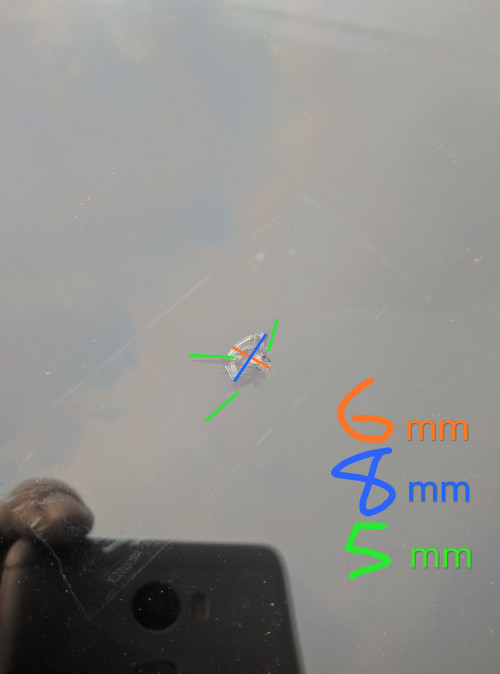

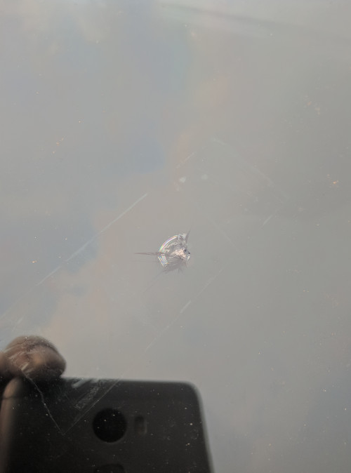

Not sure this one called chip or star. Inside is smooth not damaged. I did put some tape inside asap as I could.
How much to repair at shop? Can recommend one around puncak alam/bandar saujana area? icon_question.gif
Or just DIY? Seems there are many selling these less than rm20. Work or not?

i try b4 those DIY repair kit on worst damage than urs.
it really works wonder.
if u apply properly, can barely see the "scar".
u'll need to do it asap cuz crack grows.

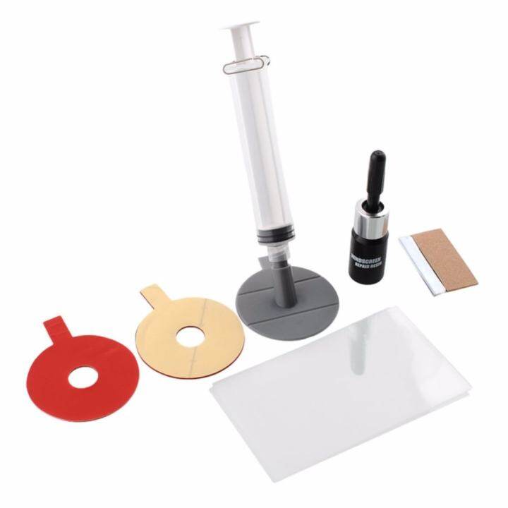

i chipped my windscreen a couple of weeks ago and used the diy method; holding up well so far (fingers crossed!)
i used the generic one below because i feel that it covers more surface area:
a couple of tips if you're going the diy route:
(1) make sure to clean the crack THOROUGHLY to get the best possible fix, use a thumb tack to get as much debris and broken glass out of the crack as possible.
(2) when applying the resin in the cup, have a hair dryer handy and heat up the inside of the windshield in order to get the resin flowing to cover the micro cracks for a better application/result
Edit: the kit can be purchased at MRDIY for around RM17 if youre in a rush but on Shopee i got mine for RM10

the DIY is for crack and not for chip
it will glue the crack together. but u need be careful not to ketuk the place again.
I know 1 fella had a crack near the rear mirror there, then he fill back. Then he sent his car to pasang dashcam and the crack reappeared.

MrDIY got.
QUOTE(spacelion @ Sep 10 2021, 04:28 PM)
I see your point.
But in my case luckily when I did(bought the kit at MrDIY), it was flawless. Pretty good job I think I did.
It wasn't my car. Just bored and I drove his car sometimes so got irritated.
Anyway, it was back in 2019. I don't know how the car is now. Shit can't even remember which car was it. laugh.gif
Hopefully my fix still holding up.
