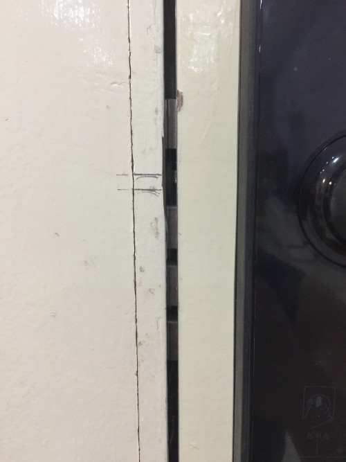

Ya... on the Mijia app, it shows door not close. There is this latch (second one from the top) that serves to detect whether the door is closed or not. I did tried to push it down with my finger and then pull the handle up... to mimic that the door is closed. When I do that, the Mijia app showed that the door is locked. But unfortunately, I can still open the door without passcode/fingerprint/key.
Since the door can be close and the anti-theft latch can come out from the lock body and fit nicely to the strike plate, I guess the strike plate is aligned properly. Maybe I'm wrong...
Sorry, but I don't understand the part u said that need to be saw off. Can u show me using photo? Thank you very much for the help... Really appreciate it.

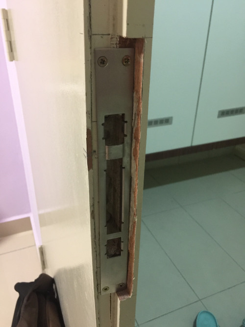

can show a photo of your installed strike plate?
Will take photo later at home... sorry just notice your message.

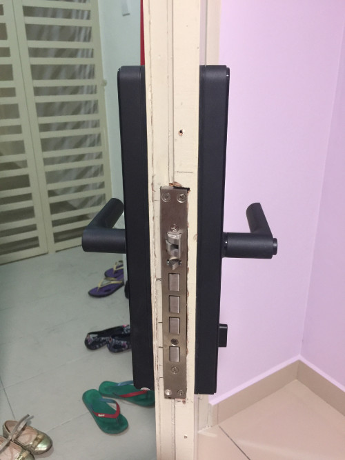

This is the photo from inside when I lock it manually. You can see that all the latches are in the correct position. However, in this condition, Mijia app still saying that my door is not close.
Very weird, right?

I suggest you double check the installation again.
The strike plate is ok.
