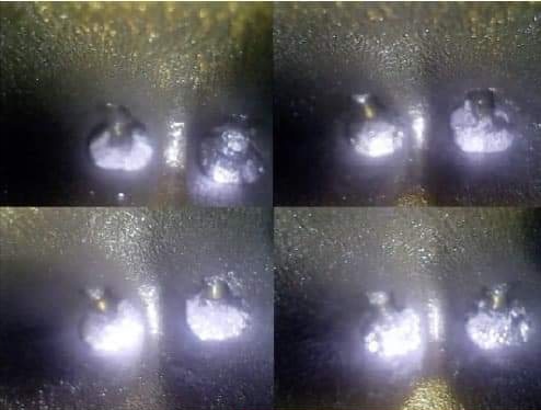

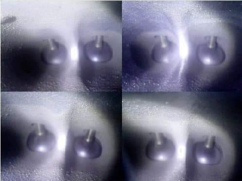

Get it right zero effect? You sure?
Direct injection engines tend to have carbon deposit on the intake valves. Over time it can decrease engine power. In serious case, it can cause misfire and CEL.
My car was plagued by rough idles and CEL going into limp mode. Changed everything from spark plugs to ignition coil, nothing fixes it.
I've even tried the hydrogen cleaning but it does nothing. Then tried cleaning the valves at a different shop. When they removed the intake manifold, the carbon deposit on the valves is just terrible. After cleaning the valves, no more CEL, no more misfire or limp mode. No hardware change required to solve the problem
it's just curing the symptom not the problem

recently i've sent my car install oil catch can, so opened the intake and it was very dirty.
so ask my mech whack 3 bottles of intake valve cleaner.
i dint take the after picture, but managed to clean the valve to a thin carbon coat (because it's just chemical spray to dissolve the oil residue)
this picture is how it looks like after i whack whole can of seafoam into it 2,000km ago.
after cleaning with 3 cans of valve cleaner, the whole car when step oil will sound better (better, faster response), definitely pulls easier.
of course walnut blast is the best method, but i just went for normal chemical cleaning
This post has been edited by AllnGap: Aug 23 2019, 02:21 PM

QUOTE(AllnGap @ Aug 23 2019, 02:19 PM)
