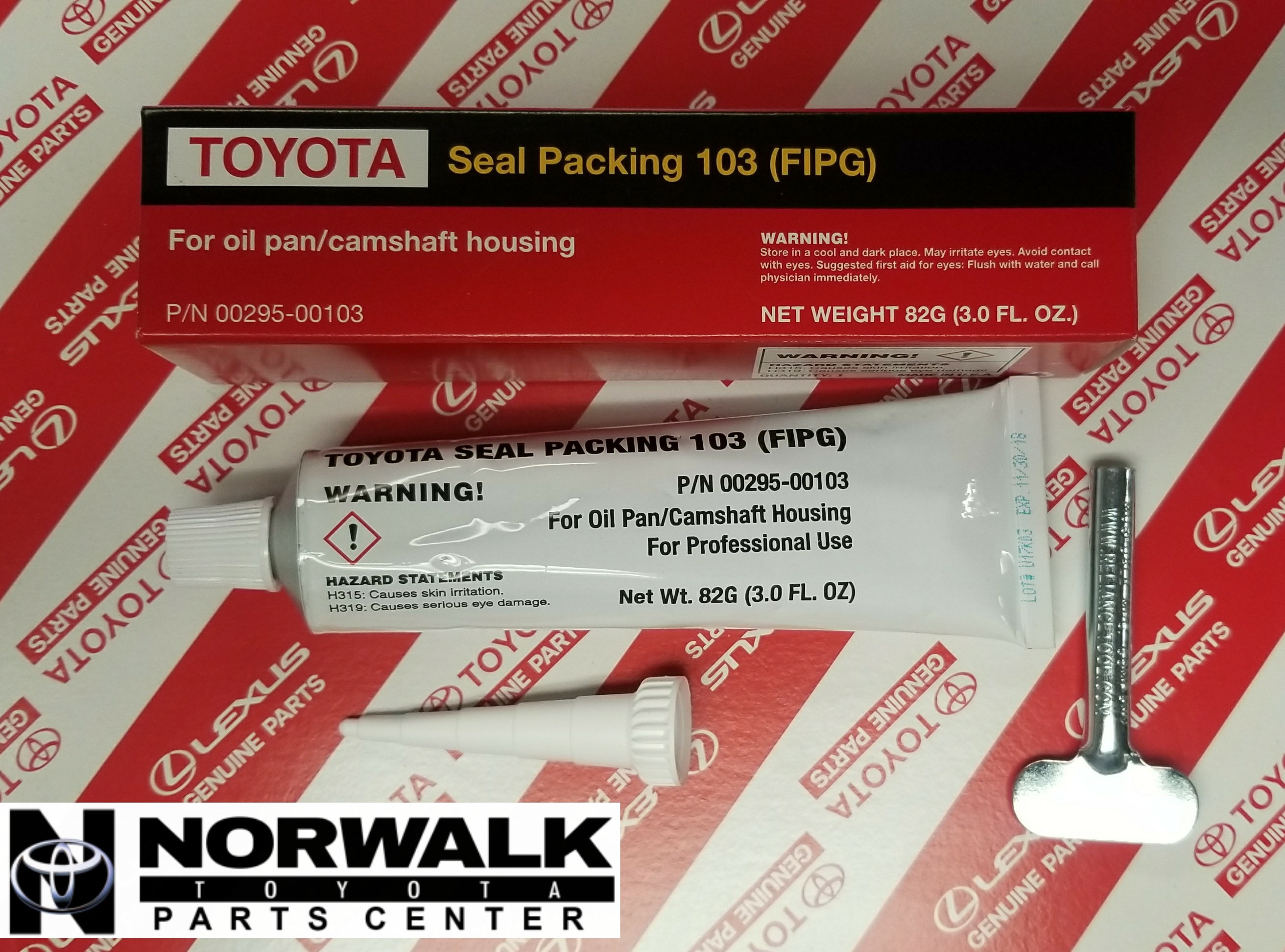

Oil pan use gasket glue

Try ask him to usd high grade silicone gasket maker, timing chain area is prone to leak if the foreman use typical grey color stuff.
Original toyota gasket maker is quite good but expensive.

Not valve seal but gasket maker glue, the one use on timing chain cover and oil pan.
Valve seal can get from sim ghee autopart at jalan ipoh, genuine nissan. Bring sample to them for double check, i think it is same as typical sr20

Toyota fipg, this is best.
Bmw or merc version also got, work great but gotta tears cry alot when try to remove it in the future.

Lol, thats a pretty common practice. It is one of the main reason to caused strange idling issue, normally people overlooked the problem.
Typical part shop got already, local toyota fipg is packed by uwm, if I'm not mistaken
