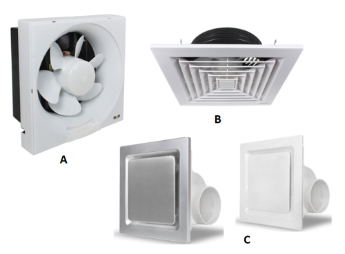

Is not adviseable to have a fan in the kitchen if you are using a gas stove. Fix an exhaust fan to draw out the hot air.
If not using gas stove, you can consider the ceiling oscillating fan which is good for tight space.

Actually we are using gas stove, and yes will install those wall exhaust fan (planning to get the Panasonic 10" type, I guess it should be OK ya? The 12" looks too big)
But the fan is more for ventilation when doing some preparations e.g. washing or cutting. Yes I'm considering this type of oscillating fan but wife said that it doesn't look nice sweat.gif

i am going to install wall fan in wet kitchen too. the fan going to blow directly to the windows facing outside + an 10" vent fan

Usually a ventilation fan should does the job pretty well because all you need is get rid of that humid stuffy feeling.
Wet kitchen please don't put fan especially you are using gas hob, 1 is safety 2nd is your gas stove will not be able to operate efficiently, I know you can tell anyone to not do that, but someone just gonna do it somehow.
