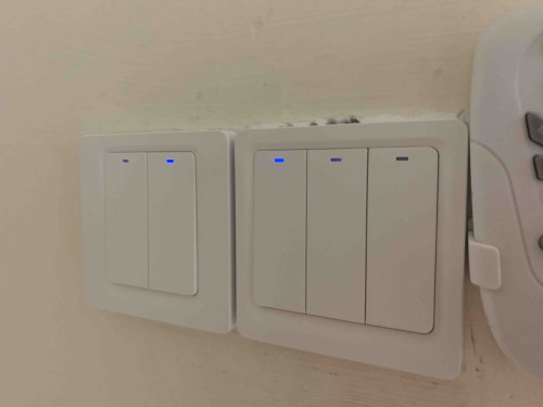

Finally my stuff sampai today
Did Zigbee Hub and replace all switch to Zigbee
And now all working

what switch is this ?
