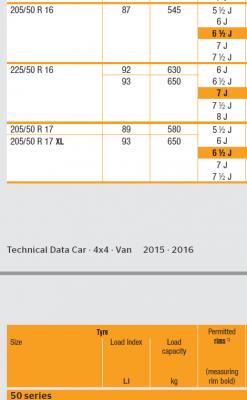

Coz your rims width is only a measly 5.5j! laugh.gif Even 195 is already a bit too wide for 5.5j even though still can. Is 195/55/16 the original stock size for that car?

QUOTE
Having said that, your tire size is odd/rare one, maybe better convert to 205/50/16 so can have many more options.
QUOTE(RicoT @ Aug 22 2018, 11:45 AM)
16x5.5j rim, safe for 205?
Yes, absolutely.

185/60R16
QUOTE(zeng @ Aug 22 2018, 10:28 PM)
Yes, absolutely.
So 205/55R16 is another option?

QUOTE(RicoT @ Aug 23 2018, 10:21 AM)
Absolutely, according to this current 2015 2016 manual!
