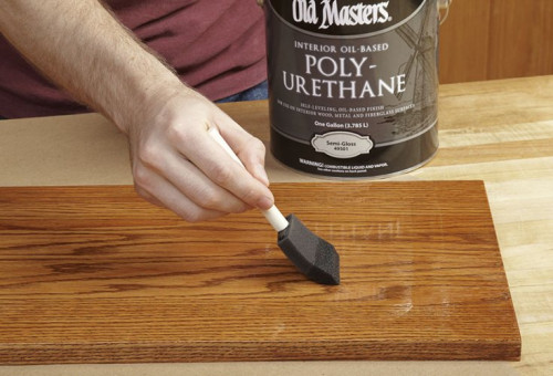

Nice DIY
I'm a sucker for wood. If me I would varnish the wood and make it glossy like this
Thanks!
I do like the varnish as well, but the top part of the board gotta be black! tongue.gif (my personal preference)
Do you suggest a PU varnish specifically?
I'm not really good at different types of varnishes.
I'm planning to do a new version of the board, more for FPS play style and also with a more premium finish.
Just have to find the time to sit down with a carpenter with a fresh set of blueprints.
Will definitely suggest to do a dual color, black + varnished wood.
Will update this thread as soon as I got more content.

I don't have specific PU varnish to suggest. TBH it depends on individual preference how you want it to look like.
