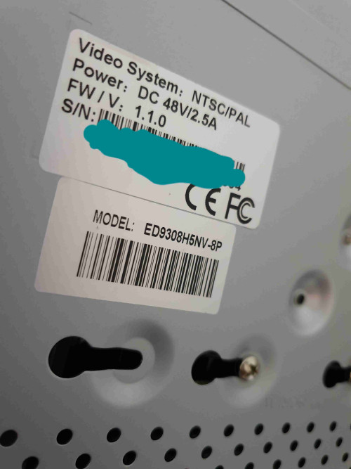

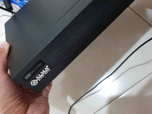

QUOTE(CDSecurity @ Aug 11 2020, 11:10 AM)
mobo = motherboard/main board
It'd help us to understand better if you can take a picture of the recorder, front panel and preferably the sticker (model) usually underneath the belly of the recorder.
Recorders without fan tend to have a higher warranty return rate for us.
Chances are if your recorder is more than 1 year old, most likely it's the adaptor issue.
Just double check if the adaptor is 12V 2A, also if the connector is proprietary like HIK recorders or just normal DC plug.

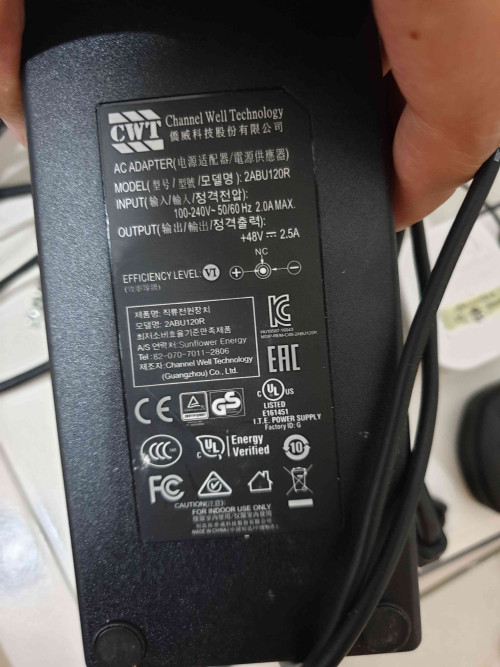

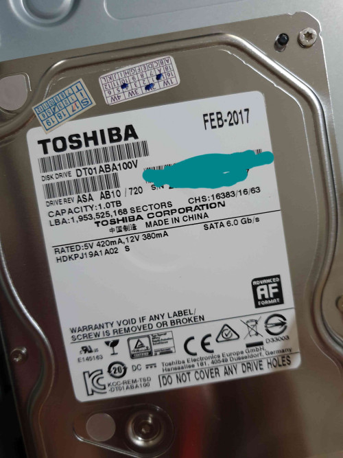

Decoder Model: Alma-ED9308H5NV-8P
AC Adapter Model: 2ABU120R, input: 100-240V, output: +48V
Hardisk: Toshiba DT01ABA100V

QUOTE(alandhw @ Aug 18 2020, 10:12 AM)
I'm assuming you're using IP cameras? 48V should be an adaptor for built-in PoE switch iinm.

QUOTE(CDSecurity @ Aug 18 2020, 02:16 PM)
Yes, IP camera 3mp.
You means my existing adapter is not compatible?
