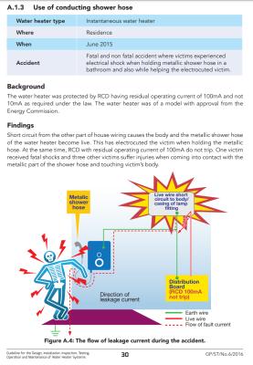

Hi, seems like most of the ppl here prefer storage heater. There was an accident last year on explosion of storage heater even when it's off. What do you think about it? How do we prevent similar accident from happening?

For the electric water storage heater there are two safety devices.
One is an electrical RCD(residual current device) & the other a PRV (temperature/pressure relief valve)
There is usually a test button to trip the RCD to see if it is working so press the trip button once a while to make sure the RCD is working
For the PRV you will need to see the hot water storage PRV drain pipe is not blocked and you can sometimes test the valve by manually pressing but hot water or steam will shoots out so be careful.
When the PRV fails the hot water cylinder becomes a cannon and will explode or rocket out its mountings making a big hole in the ceiling or take down a wall. You don't want to be nearby when that happens.

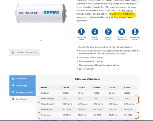

this is bolehland products and they are suprisingly good which I had used it since 2014 and it has not given me any problem so far.
it is using DC power also so it will be safer as well. but of course technically storage heater has no risk comparing to instant heater that has electronic components exposed directly inside the bathroom.

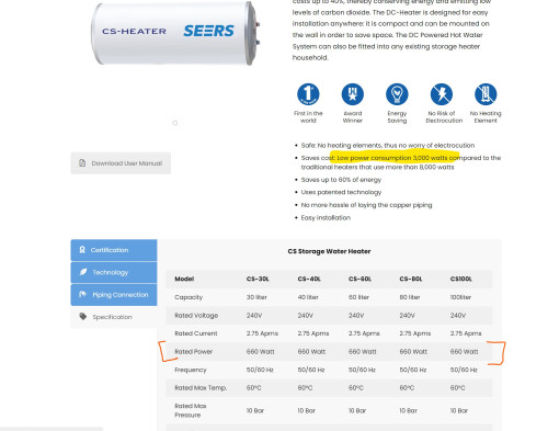

AC/DC does not matter (no difference) for a heater (resistive load). Mktg gimmick 1
Storage heater also same principle of dipping a metal heating element into water "like an electric kettle". Mktg gimmick 2
is it? this is what seers claim though.
not an electrician or engineer so cannot tell.

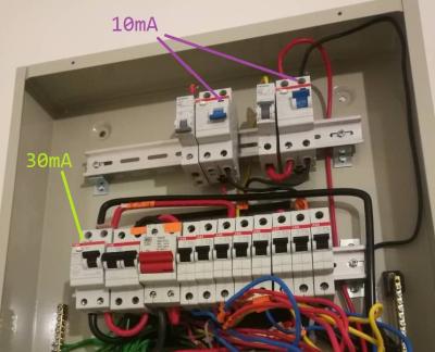

QUOTE(yuen300 @ Jul 1 2023, 11:36 AM)
That why I am interested with Seers because of what they advertis. Was like thinking to speak to their distributor or at least see the item to make the decision.
For the heater water storage, actually what we need to look out for?
Since been survey few common brands, Joven, Alpha and Elton, all their spec looks identical to me, how do we all select or make decision?
Besides that, anyone know anything that we should be aware of when install, any precautions can take to prevent electrocution?
Make sure to have 10mA RCD fitted for each water heater + 30mA for whole house RCD.
Brand of heater up to you. All the same function (electric kettle).
This post has been edited by ceo684: Jul 1 2023, 11:53 AM
yuen300
post Jul 1 2023, 03:31 PM
163 posts
Joined: Nov 2008
QUOTE(ceo684 @ Jul 1 2023, 12:50 PM)
Thanks a lots. Now I can pray the wiring guy I have would understand what this term means. biggrin.gif
Selene Yeo
post Jul 5 2023, 12:37 PM
149 posts
Joined: Feb 2021
Nearly got Seers as well last time, and after I surveying around electrical stores, hearsay from a salesperson that Seers is facing trouble from SIRIM / Suruhanjaya Tenaga for marketing misrepresentation, because some Australia / New Zealand buyers got the wrong info (they thought Seers is DC-powered due to this marketing misrepresentation), so they purchased Seers storage water heater to be installed in their camper trailer or RV. And when they found out they can't use Seers in their RV, they filed multiple complaints even to SIRIM / Suruhanjaya Tenaga.
I believe in Malaysia, no electric storage water heater, regardless of brands, are DC-powered, all should be AC-powered.
This screenshot is taken from Seers' website. See how they mentioned that their storage water heater is a DC Powered Hot Water System (highlighted in yellow) but the product specification (bracketed in red) shows rated voltage is 240V and frequency is 50/60Hz.
I am no engineer so please correct me if I am wrong, but the product specification's rated voltage and frequency is basically saying the product is AC-powered, because DC should be no frequency (0Hz). I believe this is marketing misrepresentation? rclxub.gif
Adding on to ceo684's advice, make sure the storage water heater u buy comes with and has been installed together with 2 isolation barriers (for both inlet and outlet) to prevent current leakage from water heater to u, and 1 pressure relief valve at the inlet to prevent the inner tank from overpressure which may lead to leaking tank or even worst, explosion. Most SIRIM / Suruhanjaya Tenaga approved storage water heaters should already have this prefixed together.

westlife
post Jul 9 2023, 06:26 AM
10k Club
14,291 posts
Joined: Jan 2011
QUOTE(Selene Yeo @ Jul 5 2023, 12:37 PM)
so now seers is quiet/disappeared from the market becos of this?
it is stated the rated power is 6xxW? does it still mean that it is more energy saving?
SUSceo684
post Jul 9 2023, 01:12 PM
Component Burner
11,667 posts
From: Klang/Subang
QUOTE(westlife @ Jul 9 2023, 06:26 AM)
It’s the same. Based on power formula is P = E/t, where P means power, E means energy, and t means time in seconds. This formula states that power is the consumption of energy per unit of time.
So if the energy is 1/5th (600W vs 3kW)
It just means it will take five times longer to heat up (in a nutshell). Total energy needed is the same (assuming no cooling losses etc)
Selene Yeo
post Jul 10 2023, 06:26 PM
149 posts
Joined: Feb 2021
Yeah as explained clearly by ceo684, lower rated power doesn't mean energy saving at all, it just means its heating time taken to heat the same amount of water is slower compared to those with higher rated power.
For instant water heaters where their heating elements are usually only switched on when water is flowing, higher power ratings usually equates to hotter output water temperature if the water flow rates are the same; while for storage water heaters where heating also take place when water is not flowing, higher power ratings usually equates to faster heating time taken to reach to its maximum rated temperature for the same amount of water.
Also, SEERS' product description (highlighted in yellow above) mentioned it has a power consumption 3,000 Watts, but specification (bracketed in red) shows rated power at 660 Watts. Quite confusing rclxub.gif
Additionally, one reason why I didn't get SEERS is that most conventional storage water heaters like CENTON, ALPHA, & JOVEN heats up to a max water temperature of 70-75°C, while SEERS is only 60°C. If SEERS outputs only 60°C, by the time the hot water travels thru the piping, lots of heat loss has already taken place, and the output water temperature when it reaches users might not be as hot, unless the SEERS storage water heater is placed very near to the user with minimal water travel required.
This post has been edited by Selene Yeo: Jul 10 2023, 06:27 PM
