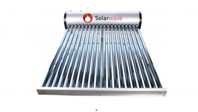

Hi...anyone know about SOLAR WAVE solar water heater??hows the quality??any comments??
