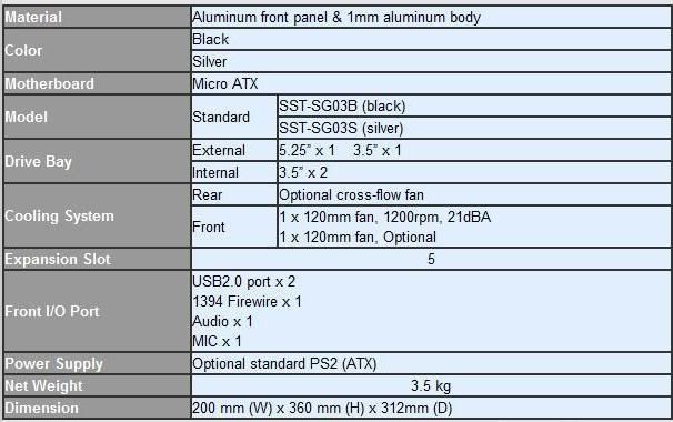

Take a look at the specifications list. If you have the time, take out your measuring tape n try to measure out the dimensions of the SG03. That will give you a really good idea of just how timy the case is.

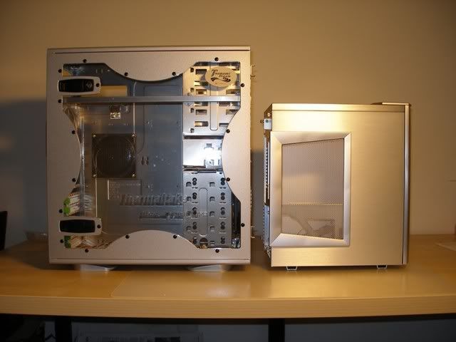

I've taken a picture of a normal sized ATX case next to the SG03 so you can make a size comparison. It's incredibly small and you can see that in this picture.

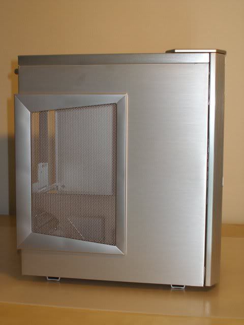

Here's some pictures of the exterior.
A better view of the side panel. Look at that big huge mesh panel. That will come in real handy for ventilating hot hardware. You never know, some crazy fella may decide to cram in a couple of 8800GTX SLi in the case. brows.gif

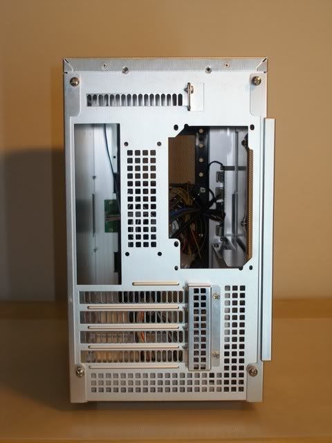

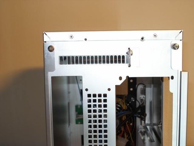

Here's a view of the back. There's lots of ventilation here. Look at all the ventilation holes.
There's even an optional PCI slot right above the motherboard. You can use this for extra peripherals like a PCI fan controller, CCFL switch, or if you're more concerned about keeping the hardware cool, you can even use a PCI slot exhaust fan. If you look carefully, in the middle between the I/O plate n the side mount PSU, there's also an optional mount for the Silverstone FX121 cross flow fan to exhaust even more hot air out of the case.
Take a look at the PCI slot covers, they're all perforated too.

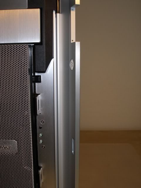

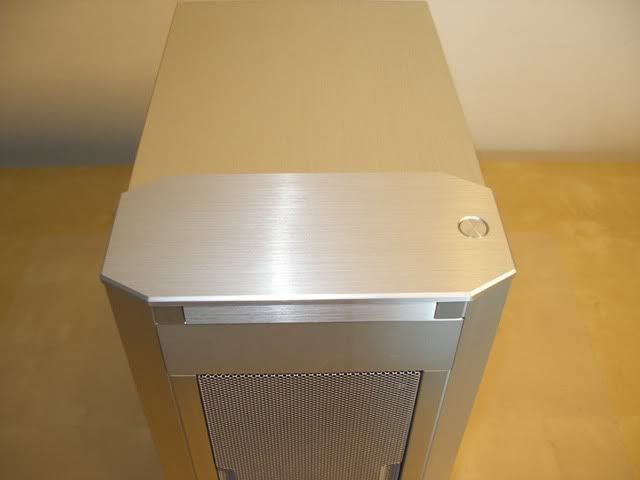

Here's the power switch on top of the case. The top plate that the switch is mounted to is made of really nice and thick aluminum plate. In fact the whole front face is nice and solid. All made of thick aluminum plates.

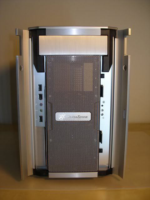

Here's the front with the flaps open on both sides. This reveals the extra USB, Firewire, earphone, mic plugs. The floppy slot is just below that. Those who dont use floppies can mount a multi card reader. The mesh plate on the front is the cover for the intake fans. This case is designed to accept 2x120mm intake fans. Only a single 120mm fan is given with the case though.
Take note of how thick the flaps are. Great construction there. Gives it a nice solid feel. The flaps are held on by magnets when closed.

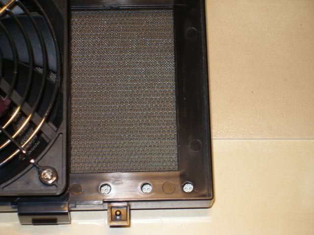

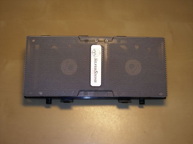

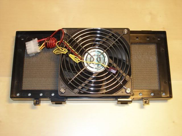

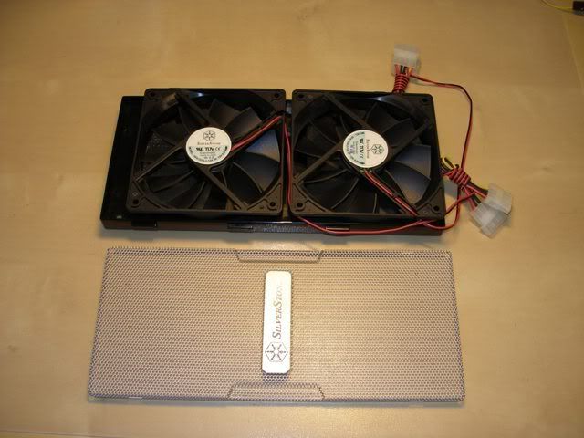

Let's move on to the front intake now. After opening the front flaps, just press in the plastic tabs on the right and the whole intake panel comes right off. Brilliant bit of design there. This will be perfect for cleaning purposes as we can just remove the whole thing for cleaning. Here's the front intake panel.
This is the reverse side where the intake fan is. The case comes with 1 fan installed in the middle.

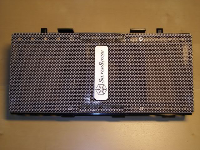

The front intake has a nice nylon netting inside to act as a dust filter.

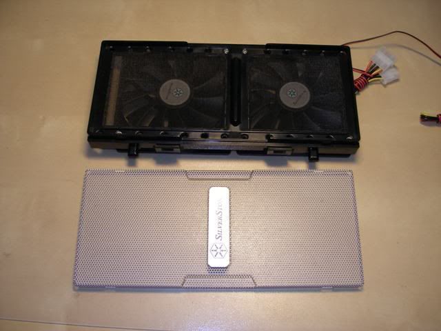

Now let's see how it looks like if I mount 2x120mm fans on it. It's a very easy process. All I had to do was lift the mesh off n it looks like this.
Just remove the 4 screws holding the fan down, mount 2x120mm fans on it and what you get is this.
Pop the mesh back on and it's done. 2x120mm intake fans on a SFF case! thumbup.gif

This is how the case looks like with 2x120mm fan intake. Most normal sized ATX cases dont even come with a 120mm intake let alone 2x120mm intakes. Temperatures should be ok even with an uber 1337 rig inside.

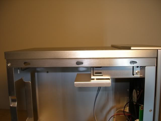

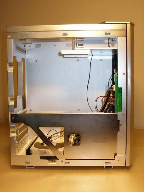

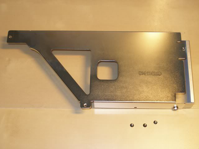

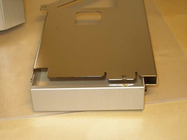

Let's take a look at the internals now. This is how it looks like from the side. The big huge support bar on the side holds the floppy drive vertically. It also supports the PSU so it doesn't droop.
The plate is held on by 3 screws only.
Reverse view of the plate.

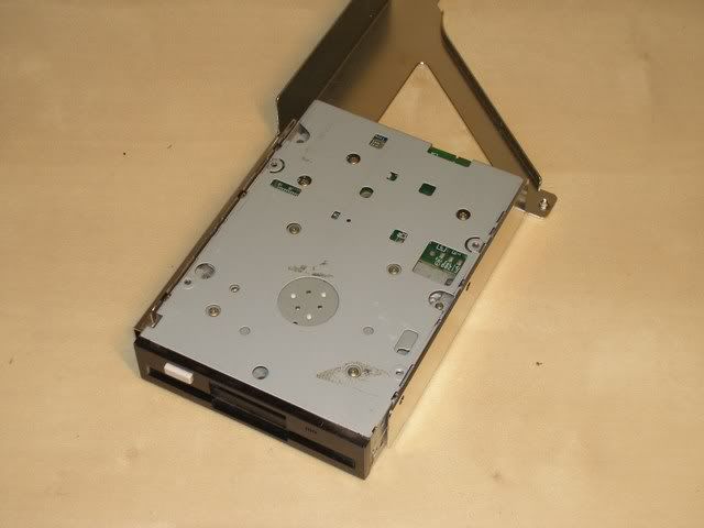

All we have to do is pop off this slot cover.
Then install the floppy n this is how it looks like.

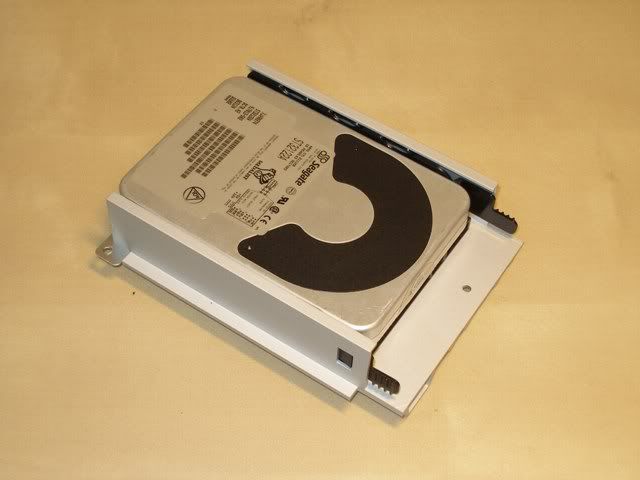

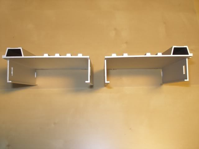

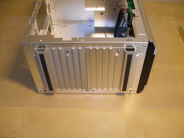

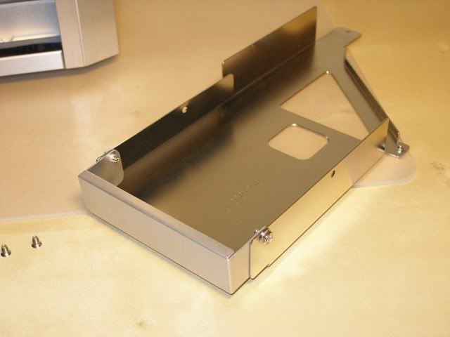

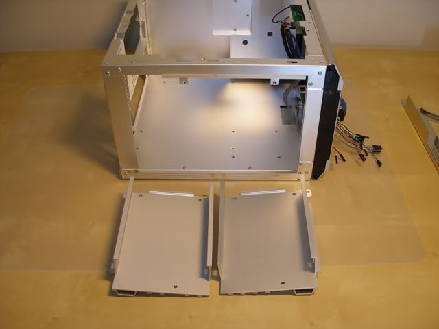

Here's the HDD mounting. It's rather unique. It sits at the bottom of the case and looks like a heatsink.
The HDD plates removed.
Check out the nice construction of the HDD plates.

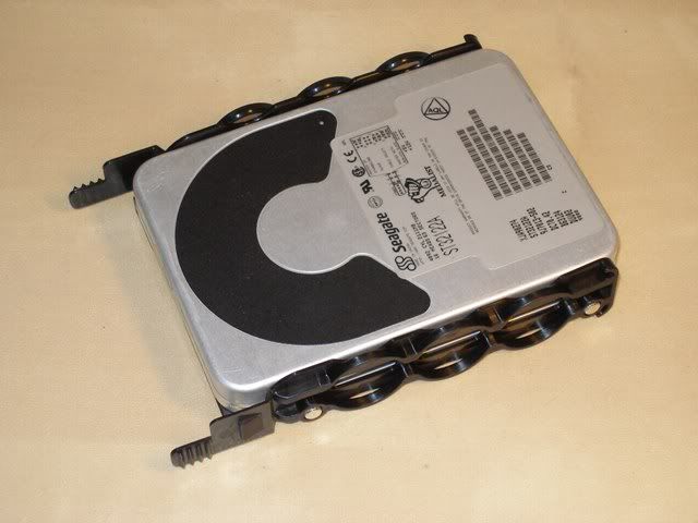

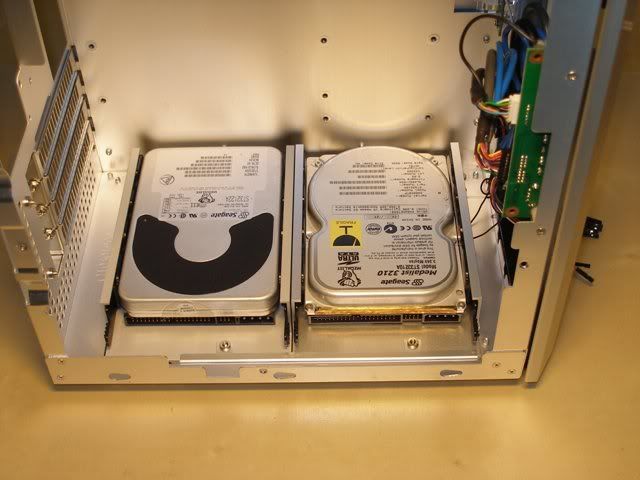

Mounting the HDD is easy. Just pop in the rails like this.
Slide the HDD in.
This is how the mounted HDDs look like in the case.
After installing the HDDs, I noticed something. There's actually no physical contact between the HDDs and the nice aluminum plates. So the nice looking heatsink plate does nothing for cooling the HDDs. I'll try using some thermal pads later when I get down to building this rig. I'll try and get the HDDs to contact the plates using thermal pads to make full use of the heatsink fins on the HDD plates.

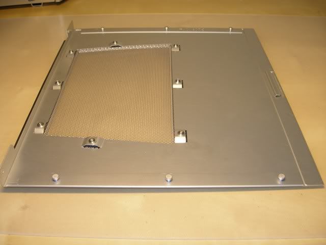

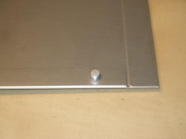

This case coems with a unique side panel mounting system too. It's really nice and I haven't seen this on other cases. It's a really nice system that uses studs. Look at the holes at the top of the case. The bottom is the same.
Here's the reverse side of the side panel.
A closer look at the stud on the side panel. This stud slots into the bigger side of the holes on the case and it just slides into the smaller part to lock the panel in.

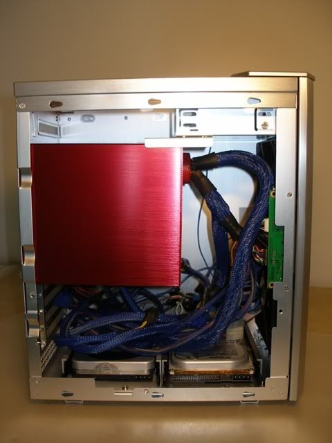

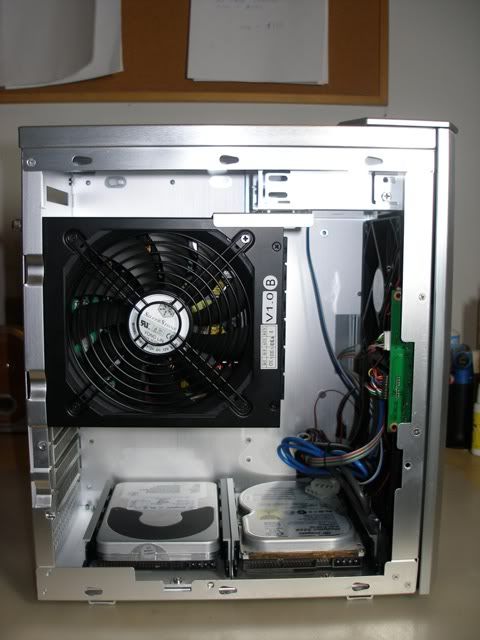

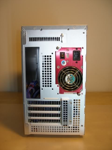

The last thing I installed for this review is the PSU. This is not a normal small sized ATX PSU. It's a 600W PSU that's much longer than normal PSUs. In fact, the Silverstone DA750 that's going into the case when it arrives should be even longer than this. As you can see, big PSUs are not a problem. It can take any monster PSU, even the big huge kilowatters. notice the cable clutter? Not to worry, I'll be using a DA750 which is modular and I'll remove all unused wires so it'll look much much better.
Here's the case with a 600W PSU inside.
Rear view with the PSU inside. From this picture we can see that there is ample space for a nice big CPU heatsink. The clearance from motherboard to the back of the PSU is about 8cm. I'm pretty sure my Thermalright XP120 can fit in there. Silverstone guarantees that the big huge Nitrogon06 fits though so we dont have to worry about fitting aftermarket heatsinks.

TSianho
post Jun 27 2007, 05:48 PM
Cucimangkoklife
VIP
15,705 posts
Joined: Mar 2005
From: Tg. Rambutan
Here's the OP750 that Silverstone sent to me. I'll post up some pictures of it inside the SG03 just to gif u guys an idea of how a 750W PSU looks like inside the SG03.
Pix of the PSU inside will be up shortly. Taking the pics now.

TSianho
post Sep 2 2007, 01:04 AM
Cucimangkoklife
VIP
15,705 posts
Joined: Mar 2005
From: Tg. Rambutan
Here's the new pic I promised earlier. I thought of reviewing it with the OP750 but I've decided to put the latest Silverstone Strider 1000W in it. As you can see, the SG03 takes a 1000W PSU without problems. thumbup.gif The PSU can be turned around so that the 13.5cm fan faces the CPU HSF. This will help exhaust the hot air out of the case.
blackshirt
post Sep 12 2007, 07:25 AM
Goodwell Car Detailer
1,313 posts
Joined: Nov 2004
From: KUL, MAL
lehteck
post Sep 12 2007, 09:06 AM
2,408 posts
Joined: Jan 2005
