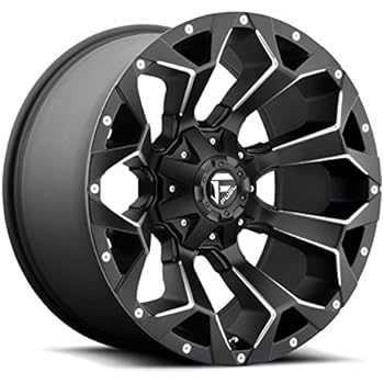

yup fully agree with u.. it does have certain force while on the roads
i do like black rims, recently i happen to find out about Fuel Offroad rims, those are pretty nice rims.. however not sure they come with 16 inchers though, and wonder how much they will cost too..
or the Lenso Zeus also looks great too
