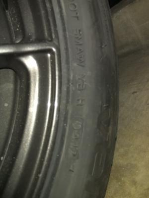

Guys do you guys check tyre manufacturers years? I went to hankook website for the guide.. But seems out of 4 tyre I only able to find 2 which is in passager side.. Is it confirm have the stamp of manufacturer's? The 2 I saw is week9 of 17 and week 4of 17 assume I see it correctly

0917 represents workweek 9 of year 2017.
Not September 2017.

I see.. Thanks for the clarification.. But how come 2 of it don't have.. Is it possible diff location?

Maybe the guy salah pasang. Check the other side. Inside facing the car.

That tire is the V12 Evo 2, is it? I see the rotational direction indicator there so it must be a directional tire which is the V12 for Hankook. For directional tire, you just need to follow that rotation indicator. Now the manufacturing year is often only printed on 1 side, hence that's why you cannot see it on the driver side after installation as it will be in the inside.

v12 is directional/rotational tyre.if follow the direction the date of two tyres are facing outwards and another two will be facing inwards.

Yes you are correct for the tyre model.. Meaning the 2 that do not have date should be in left or either right, and must not front have rear don't have or vice versa rite?
