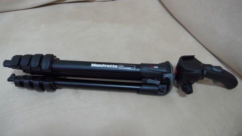

But when you put both together side by side, the 718B literally dwarves the Modo. And it weights a hefty 750gm (compared to Modo=1kg) more, then it's about a a palm's width longer or so. Not to mention how fat it was. Some of you might argue that the heavier tripod, the better. Which I agree, if I had my D200 smile.gif But for this case, I am going to use my LX2, which weighs only 217 gm (0.48 lb) (with Battery and SD Memory Card)!
So, Modo it is.

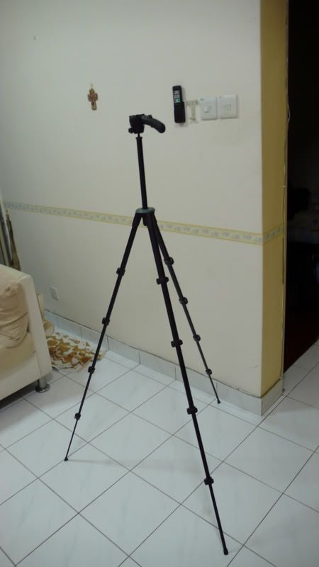

Actually the Modo stands pretty tall when fully extended (150cm). I kind of have to agree that it is a bit shaky when fully extended, including the center column, but then again, you should not need to fully extend the center column for most shooting situations. The legs alone are tall enough for a well composed group photo.
Standing Tall

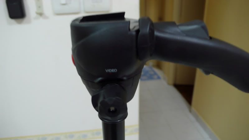

The most outstanding feature of the Modo is the new level operated, Video/Photo dual mode ball head. What this means is that with a twist of a knob, the ball head will either go full tilt in any angle (Photo), or move vertically and horizontally along the X-Y axis only (Video), which incidentally is great for taking panning photo shots.
Quick twist mode changer

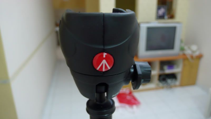

The quick release has a non-standard shaped quick release plate, which I wonder whether I can buy a replacement if I accidently lose mine. It does not have the key ring around the knob/screw (which I liked in my friends's Manfrotto), although there is a plastic screw tool which is attached at the base of the center column. That can be used for screwing in the plate on the camera.
Front View, with logo

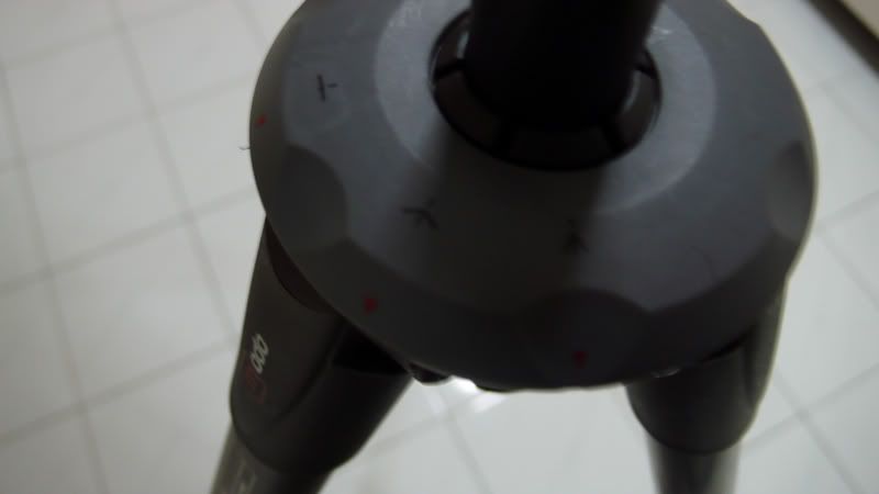

Another unique feature that I really like is that the Modo supports going down really low for object/macro shots on the flow. This can be done with a simple twist of a small plate on the tripod, and has a satisfying "click!" when it is in place. But you must remember to keep the legs straight when doing this.
Just twist the grey plate and get (the tripod) down!

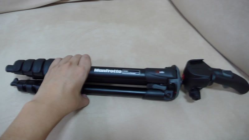

Look how tiny it is! (the tripod la, not my hands)

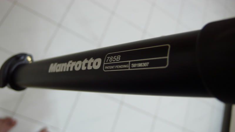

Speaking about quality, although the leg quality feels great, I can't say about the plastic parts. It's just not as polished as I like. Some of the molded plastic, like the ball handle, does not quite align 100% between the left and right parts. Even for the grey twist plate, there were already scratches when it came. But I guess those are more cosmetic problems than functional ones. Not to forget, there is a build in spirit level also, but I don't think it's mush use to me, since I am more free-willed when taking pictures smile.gif Finally, if you position the head correctly, you can carry it like a BFG2000 smile.gif
Don't make my day!

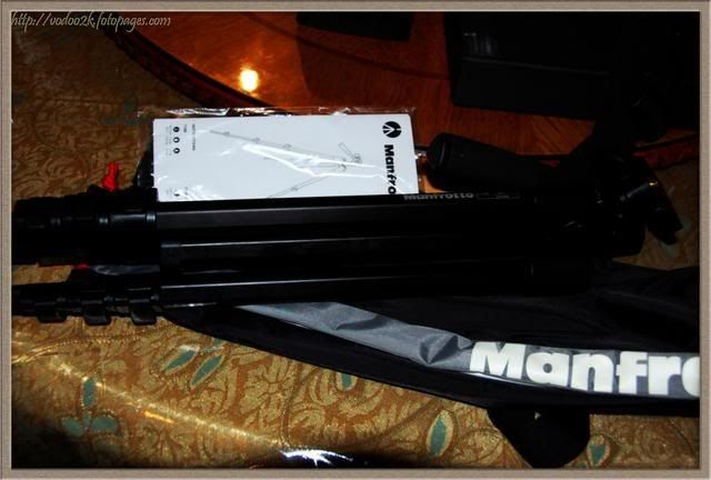

Nice buy man.. actually, i bought this one before changing to a more sturdy manfrotto tripod. This modo got a max load of 1kg whilst all my gear weights close to 2kg hehehehe.. Anyways i love the gripper heheheh.. superb. I wished that my new tripod got the same system but unfortunately its the conventional one hehehehe.... Anyways mind to share the price?
