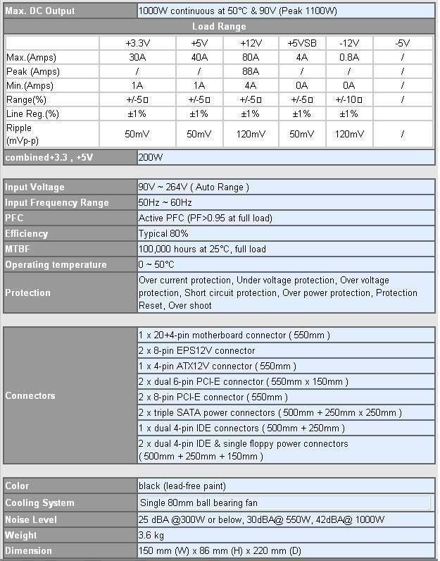

Chart taken from Silverstone's website.

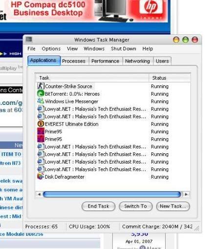

Pictures of my desktop running all the programs for torture test.

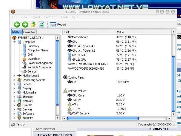

Let's move on to the real world performance now. The above spec sheet is the system I used to test the OP1000. I ran dual instances of Prime 95, Bit Torrent, MSN, 6 pages of Internet Explorer and Disk Defragmenter while playing Counter Strike Source at 2560x1600 and maximum graphics options on. Just take a look at the screenshot of my desktop in the picture above, look at the sheer amount of programs running!
Take a look at the Everest console and you can see the voltages were rock solid while doing all that. The voltages didn't drop at all. The 12V rail stayed at 12.35V, the 3.3V rail stayed at 3.39V n the 5V rail stayed at 5.13. Even when they fluctuated, the fluctuations were extremely small. The fluctuations I noticed were only 0.01-0.03V for all 3 rails.

if you guys wanna grab Silverstone 1000W PSU with modular design, you can check Decathlon series, the spec almost same as Olympia 1000, it's just modular and non-modular...
in terms of +12V current, this is the strongest current on single rail i ever seen, >80A; 88A (peak) thumbup.gif.

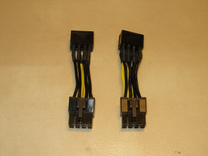

i wonder whether the 8pin pcie connector is correct? if i'm not mistaken, if it's rev 1.0 then the 8pin pcie for R600 is incorrect while OP/DA psu rev 1.1 has the correct one. it's not mentioned in you review though. i would really like to know whether the rev for this psu in m'sia is 1.0 or 1.1, thanks.

QUOTE(Sanko @ Apr 5 2007, 09:16 PM)
It's 8pin PCIe 2.0. That shud be right for the R600.

QUOTE(ianho @ Apr 5 2007, 09:36 PM)
is this the one?
http://www.jonnyguru.com/forums/showpost.p...192&postcount=1

@ Sanko. According to the jonnyguru pics, I have the wrong plugs. No big deal. I'm sure they'll send me the correct plugs soon. thumbup.gif

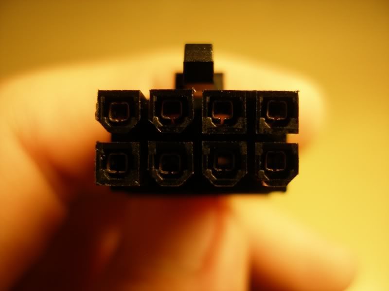

hmm.gif, just take note guys, v1.1 is the correct 8-pin PCI-e, thus no need to get an adapter smile.gif
the right one is the correct 8-pin PCI-e connector (D-Shape), look at the bottom red-rounded, D-Shape and non-D-Shape
