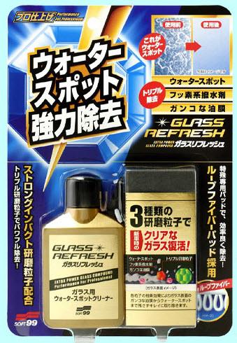

QUOTE(Reozen @ Jun 5 2017, 10:26 PM)
You can try use Soft 99 Glass Refresh  thumbup.gif  user posted image
You've used it before?
It's effective against stain like mine?
And how to use? All instruction in Japanese
I see they only sell online, any shop got?
This post has been edited by IReallyNeed Answers: Jun 5 2017, 10:38 PM
