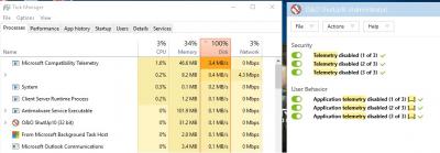

The thing keeps coming back. Even after I disabled it through GPEdit, the process keeps popping up.
And it hogged so much of the CPU processes, which explained why my laptop slowed down to a crawl after every bootup.
Any way to kill it once and for all?

i don't think it can be killed "once and for all'. it's possible that it will come back after new windows updates are applied.
have you used this one before? https://www.oo-software.com/en/shutup10

It even appears after disabling it, wouldn't be surprising if an update revives that thing.
I've not, but would give it a try. Thanks.

It's back, like a zombie.

Did you reboot your computer?
I'm not sure how i did it but this thing is absent in task manager of my computers for now. I did use gpedit, shutup10, and also remove 2 services manually iinm (forgot the service names but you can look them up via search engines)
edit: i also disabled many things during the initial configurations after a clean install, before i go into the windows desktop.

I did, and that bugger still came back. What's worse is that I just saw two instances bangwall.gif
FYI, it's part of the Windows Feedback feature. The thing that snoops on our data.

The feedback isn't grayed out on my side, but I followed the Command Prompts command from another website to disable the thing. So far, it hasn't appeared but funnily this time the NVIDIA Container is the new culprit laugh.gif
Guess that I'll find some other ways to "kill" that thing.
EDIT: Telemetry is back...

That seems like alot of work just for one process laugh.gif but I think I've found the solution thanks to one commenter from this website:
http://www.askvg.com/truth-behind-disallow...-in-windows-10/
Disabling "Connected User Experience" via GPEdit or Task Scheduler. The moment I disabled it (previously Command Prompt didn't do anything which was surprising), I didn't see the Telemetry return.
