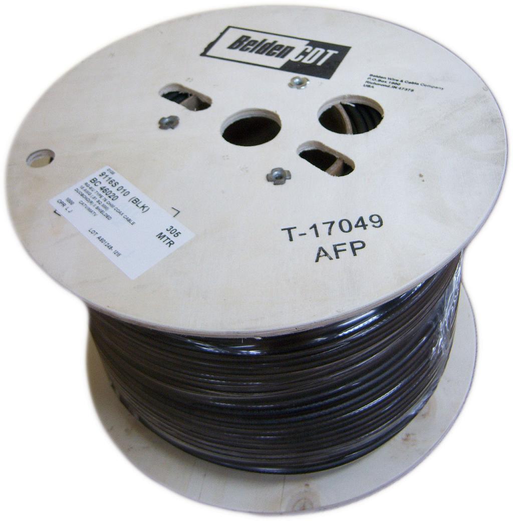

this company selling RG6 305 meter drum for rm 318, good deal?
http://www.lelong.com.my/9116s-belden-usa-...7-01-Sale-I.htm
joe_mamak
post May 3 2016, 10:20 PM
363 posts
Joined: Dec 2006
QUOTE(JimbeamofNRT @ May 3 2016, 10:13 PM)
Sorry, not up to date on prices.
But it seems fine.
No, not ok. You might as well buy from a reputable hardware shop china made but full copper. This Belden is CCS (Copper Claded Steel)

QUOTE(adamw @ May 3 2016, 10:44 PM)
Is CCS bad?
I think there are pros and cons.
For long runs, then full copper would be recommended to reduce voltage drops.

QUOTE(joe_mamak @ May 3 2016, 10:52 PM)
Is CCS bad?
Yes, full copper is for longer runs and voltage is using different wire to power up the camera but since can get full copper at same or lower price, no reason to use CCS.
cool! thanks for the info!
