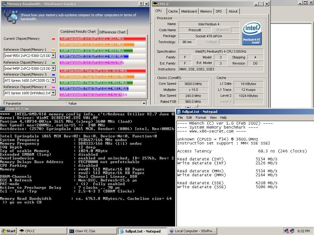

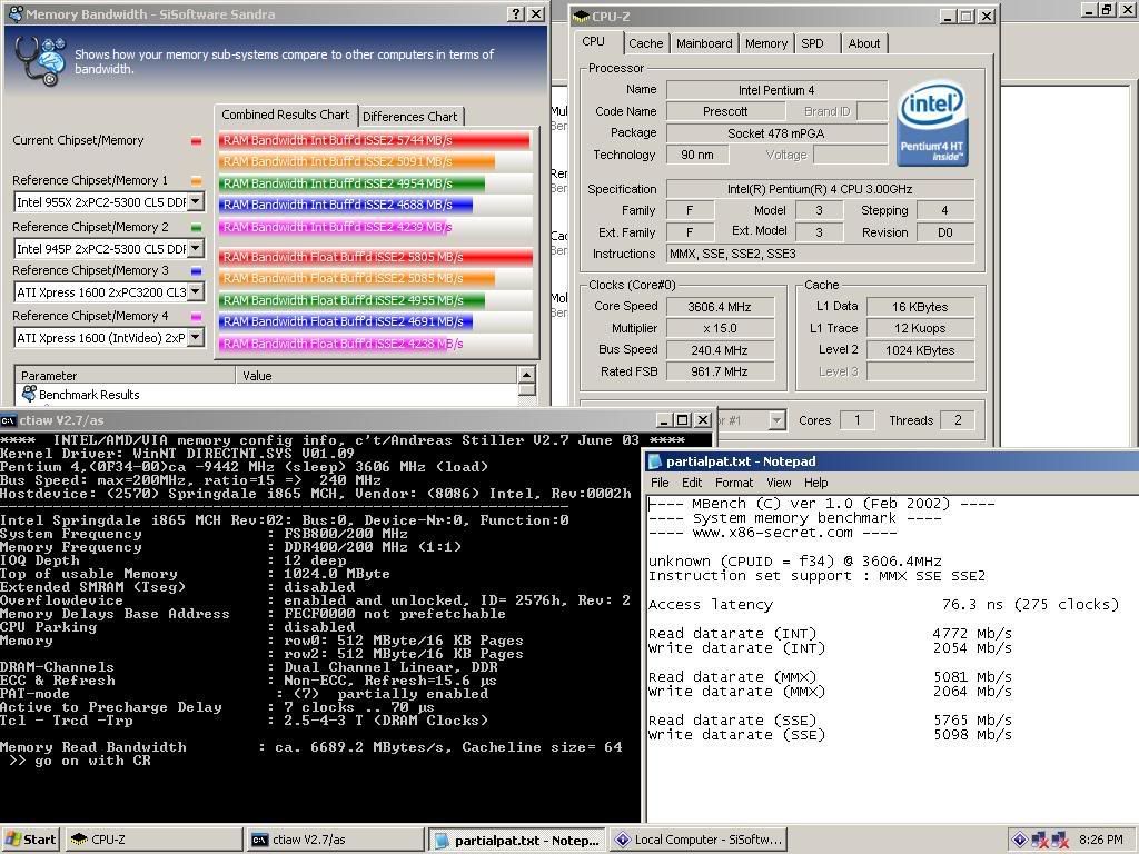

Added on August 21, 2007, 9:03 pmHere are my benchmark screenies.
No PAT enabled
Partial PAT enabled
Full PAT enabled
As you can see, full PAT gives a considerable 200MB boost over not having PAT enabled. Funny, for some reason having partial PAT enabled drops the scores instead of increasing them. Also, do forgive about the CPU-Z screen and the image sizes, these screens were done in a hurry laugh.gif
All tests were done with the same settings in the No PAT enabled picture to ensure the scores don't change. smile.gif
