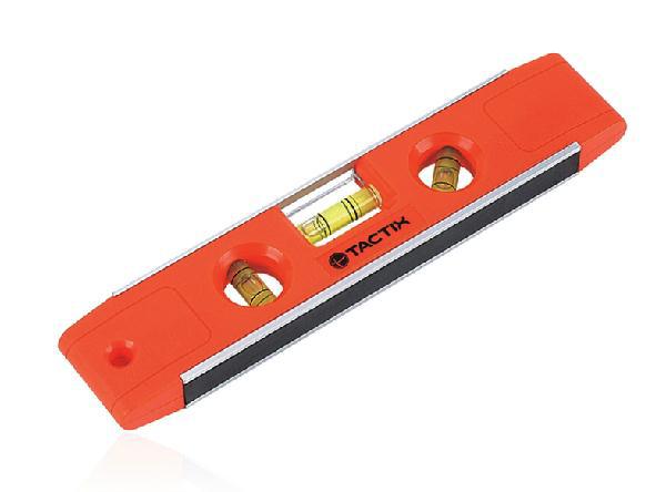

use a spirit ruler.
use this to level and mark ur holes.
during drill time, use a slower speed to mark the hole and then speed up and punch through

water level, L ruler, plumb bob is the tools that u gonna need
drill slowly, once u entered ard 0.5 cm, can accelerate
