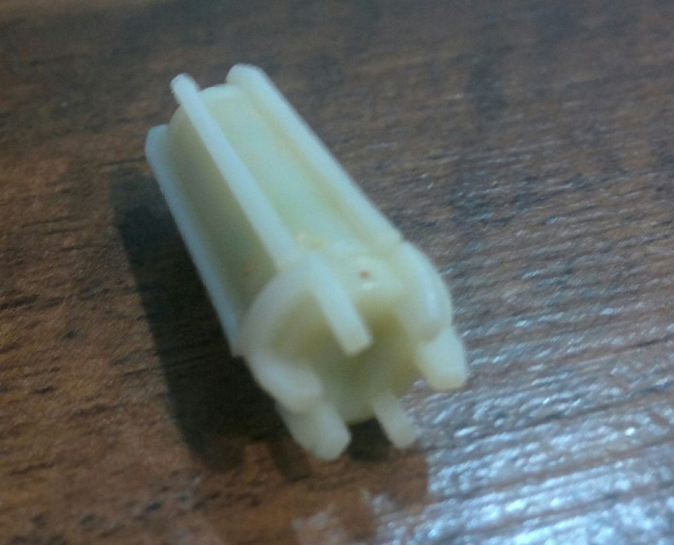

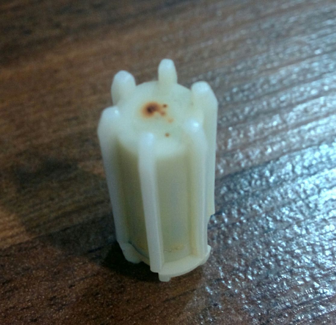

I've had this same problem, the Joven guy came to fix it. It's cause by a small white magnet like below pic, total cost only 30, magnet and labour incl...

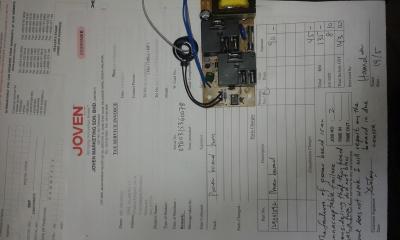

I just had Joven service repair done on the Model 880P due to no power or function . Service person replaced the power board EELS- 3D Rev 2. This is my first and last use of Joven Instant water heaters because of this failure. I checked bad board fuse and most components are good. If anyone has the circuitry, i would like to determine the root cause of failure.
All other instant water heaters in my home still good after 25 years, but im curious why this Joven model failed so fast
I found the transistor BC546B faulty and replaced. It is working good now. Hopefully it is reliable. My experience says Joven is not reliable compared to Panasonic based on my experience.

That's the magnet located inside the pipe just after the water valve in the Joven heater
It activates a reed switch on the circuit board to switch on the water pump/heater..
If there is low pressure or as the magnet ages it loses its ability to magnetise (activate) the reed switch which in turn won't switch on the Joven built in water pump/heater..
that magnet has to be replaced and it'll work as normal..
It's a common fault..
