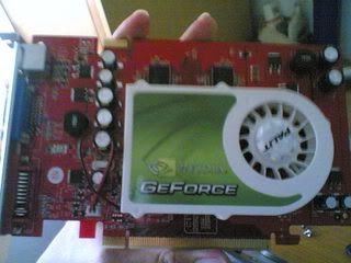

here's a picture of my palit 7300GT
1st thing i'm wondering is why my card look different from the others
2nd is i totally no idea how to take out the fan to change others
3rd is what fan is suggested for this card? thx in advance

^the below side of ur GC should have screw to hold the heatsink
u can remove it by unscrew it

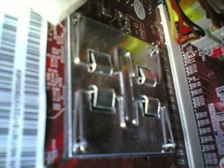

bottom view
my full load temp is @ 70-75C when i oc to 550/1200,so what budget zalman fan is recommended?

i cant c clearly
is there any link available so i browse the clear pic?
picture updated,now should be clearer view

the only way i see possible is to pull the pins outwards
like below
edit: plus dismantle it as seem fit tongue.gif

^i think the way to cabut the HSF by raising the lifter & dig out all the 4pin at the same time together sweat.gif

oh well, the view of the heatsink taken off

1) Palit design their own PCB, thats why its diffrent from other 7300GT, same as Galaxy
2) There are some reviews, try google
3) Zalman VF-700Cu is a good cooler
