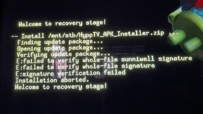

post Jun 10 2015, 10:10 AM
103 posts
Joined: Jun 2007
Anyone facing problem like this?

arkbird83
post Oct 23 2015, 07:13 PM
64 posts
Joined: Dec 2009
Can someone help me.. I'm tried this method.. But error.., can someone guide me 0124624945 tru wasap thanks.. My hyyptv box STB-HUAWEI-EC61606V5-TM android 4.0
This post has been edited by arkbird83: Oct 23 2015, 07:19 PM
Attached Image Attached Image

post Aug 5 2016, 05:36 PM
~GGMU~
1,853 posts
Joined: Feb 2010
try all step
google everything
tried flash old firmware
all end up with this
error
E:failed to verify whole-file sunniwell signature
E:failed to verify whole-file signature
E:signature verification failed
help..
im using HyppTV EC6106V5 huawei
queenc

error
Need help.

Hi,
Thank you for sharing this.
However i still getting this error when trying to flash
Also, where i can get the google play store and SuperSU root to apply to this box EC61606V5 ?

Hi all, im trying root by follow above step. But, log showing "Signature verification failed, Installation aborted'.
Anyone known how to overcome??
thanks.

QUOTE(nesak83 @ Sep 20 2016, 04:10 PM)
Hi,
I have the same problem

I HAVE SAME FILE SIGNATURE ERROR ANY SOLUTION
my EC61606V5 streamyx
anyone can help ?

i have the same error as well, did any one try with this old firmware ?
