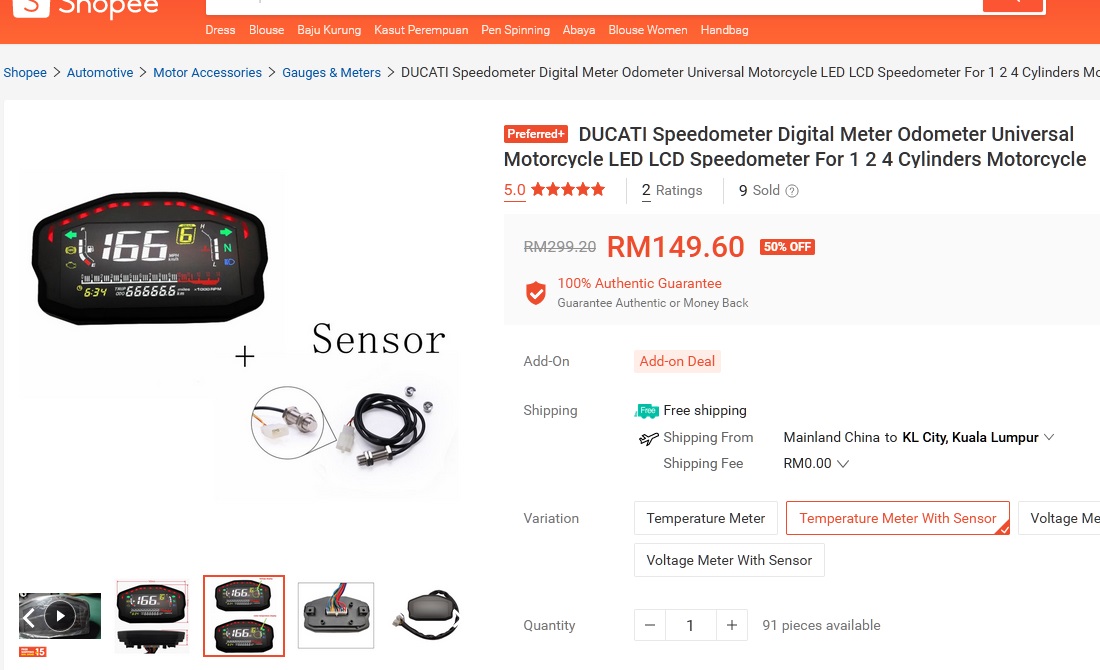

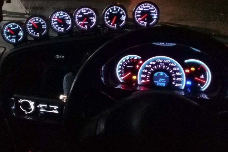

isit possible to DIY meter Digital motorcycle into wira carb? speedometer sensor maybe from kancil...
https://shopee.com.my/DUCATI-Speedometer-Di...51-3a7fcbc16c5f
meter myvi, owner DIY using speedometer sensor kancil facelift
edit, accidentally found video from shopee
https://shopee.com.my/product/280196845/6046178672

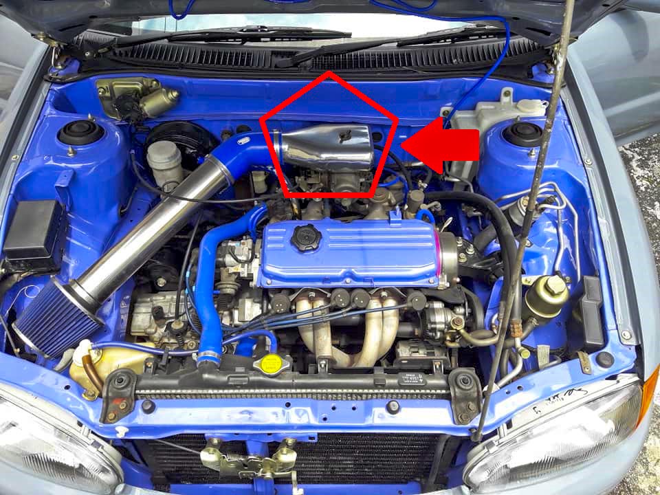

where can get this carb intake pipe?
gonna revive my late father's wira after hibernate since 2018
This post has been edited by croydon: Jul 27 2022, 11:08 PM

QUOTE(croydon @ Jul 27 2022, 11:07 PM)
this is caburator. you can find similar kind of air intake in Shopee

QUOTE(croydon @ Jun 8 2022, 08:28 PM)
there is a seller in Shopee customized it.
