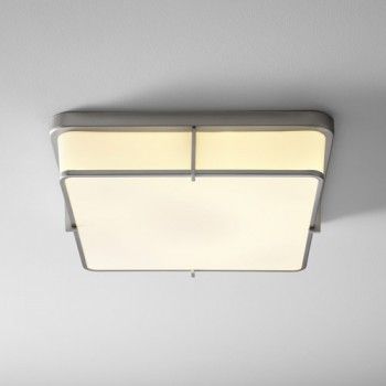

like this?

like this?
this should be office use...KLCC tower office using this type.

QUOTE(daylight2013 @ May 8 2014, 10:24 AM)

QUOTE(brutalsoul @ May 8 2014, 10:27 AM)
em...from statement i think heeren only have plain ceiling. as picture shown it is 2x2 ceiling and will reduce ceiling height and also costly.
Anyhow, got suggestion for just plain ceiling? cos i m having the same situation. hmm.gif

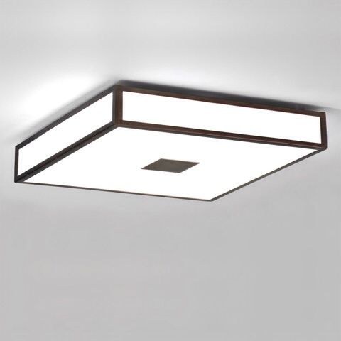

No plaster ceiling in whole house? Then, I will perhaps have some pendant lights, track lights or maybe some squarish ceiling light like following:
