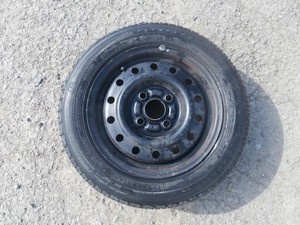

The steel rim looks like this, usually comes with cap:
The usual "sport/alloy rim" is similar to this:
Steel rim is generally more durable.

QUOTE(Alan @ Jan 8 2014, 11:23 AM)
I'm using the alloy rim (as in the 2nd pic you posted). No cracks so far, the tire shop tauke told me that the rim is dented and that the chambers have sustained damage as well.
