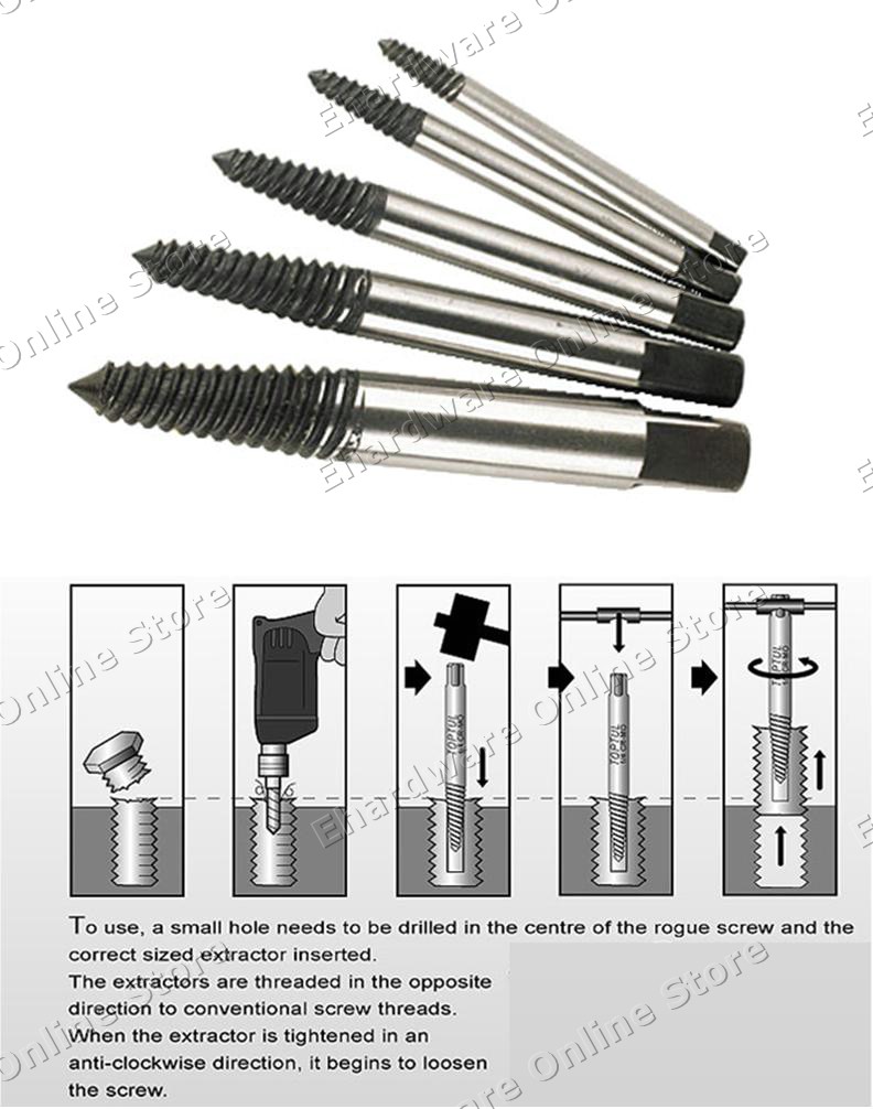

Bubble Ring
post Nov 25 2013, 09:38 PM
84 posts
Joined: Jan 2012
QUOTE(bsb85my @ Nov 25 2013, 11:26 AM)
Thanks for the suggestion. If possible I would like to DIY
To extract remaining jammed thread, use below tool.
To order correct size, measure the inner diameter of jammed pipe thread.
Image credit: ehardware2u
cucubud
post Nov 25 2013, 10:24 PM
Super Moderator
3,076 posts
Joined: Jan 2008
These extractors are mainly used to remove broken screws. I don't think you can use them on a hollow pipe. Especially the hollow pipe has a big hole.
Bubble Ring
post Nov 25 2013, 10:36 PM
84 posts
Joined: Jan 2012
QUOTE(cucubud @ Nov 25 2013, 10:24 PM)
Do you know that the extractor come with various size?
