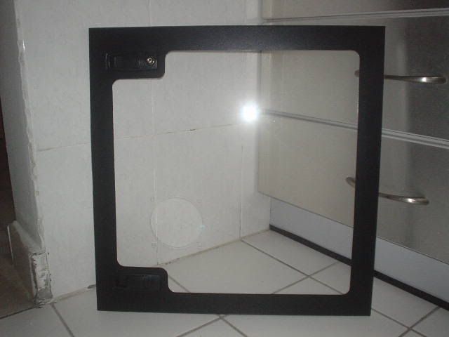

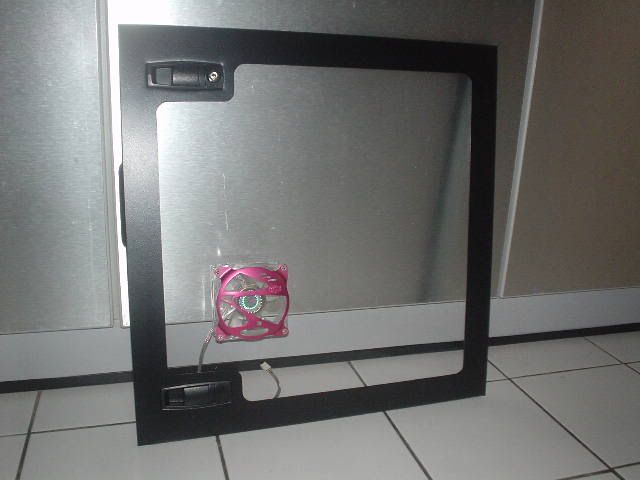

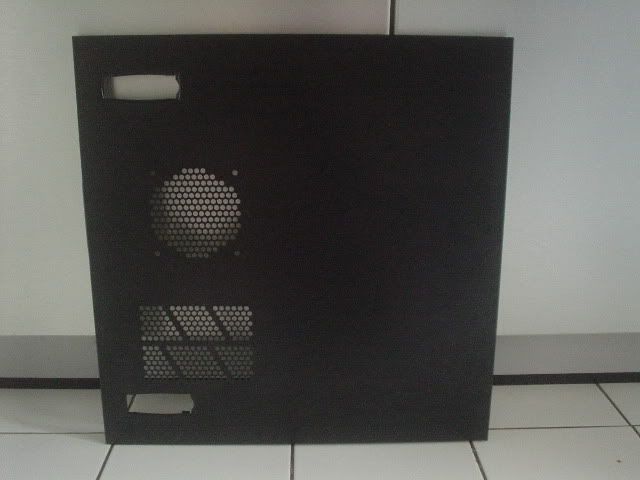

Here's a really new case I modded today. In fact I didn't even realise there was an Armor Jr. Kakaka. Anyway, here's a window mod I'm doing for it with fan blowhole to cool a pair of 7900GT SLi.
Here's how the standard side panel looks like.

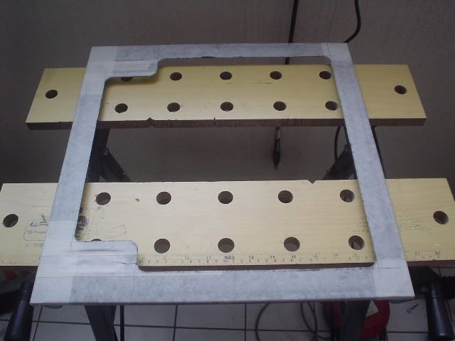

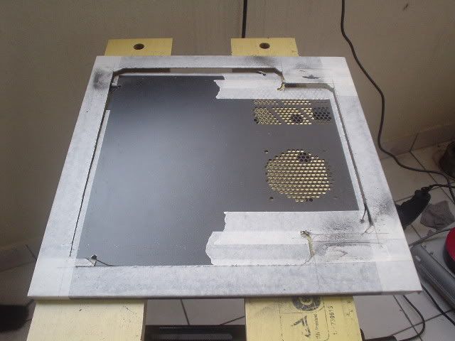

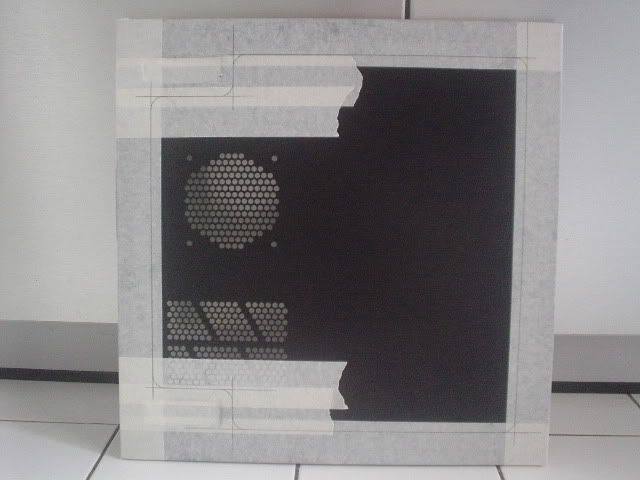

1st thing to do is use masking tape to mask it up. Then measure n draw out the window outline.
Here's where the fun begins with power tools!!!!!!!! rclxm9.gif rclxm9.gif rclxm9.gif
I cut it carefully while wearing protective goggles. Thank god I always do that as while I was cutting, 1 of the dremel discs shattered. sweat.gif sweat.gif
Here's the panel after cutting. After this step it'll be down to filing for the finishing touch.

wats d size of ur dremel disk?

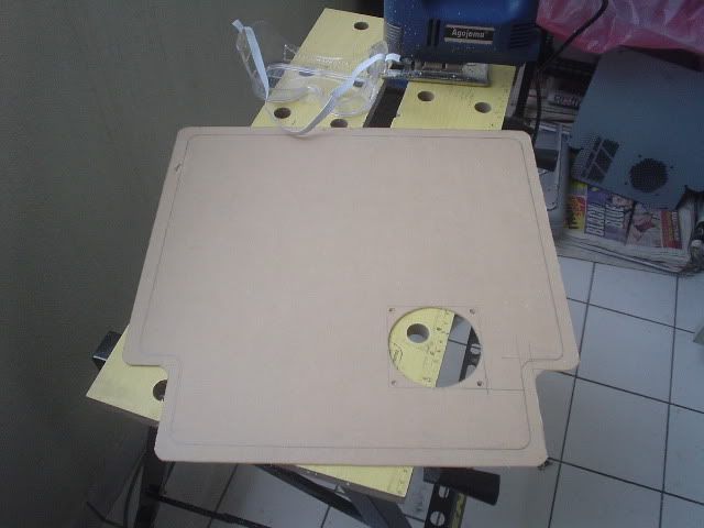

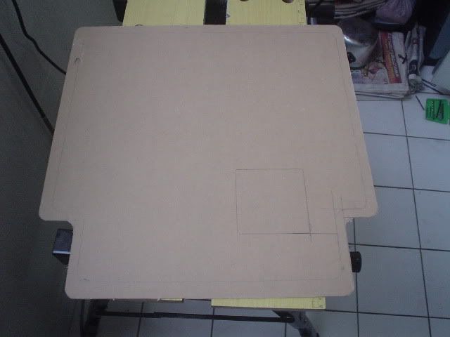

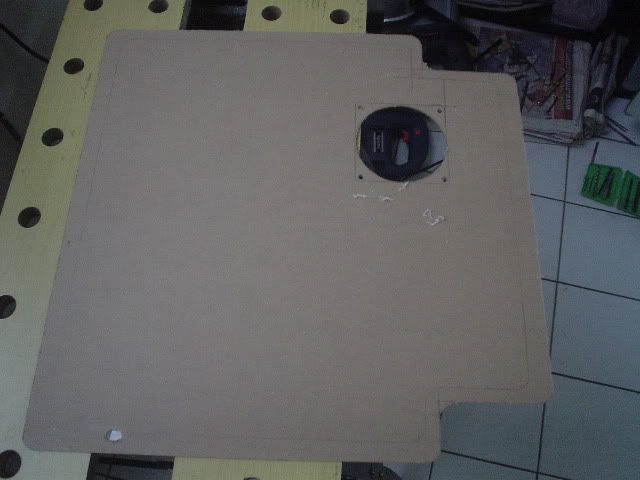

Now it's time to cut out the acrylic from the big sheet I have. Cut out a square piece according to the size of the window. Then I drew the shape I wanted to fit the window.
After cutting the proper shape I needed for the window. Now it's time to draw the outline for the fanhole.
Then it's time to start cutting the fanhole.

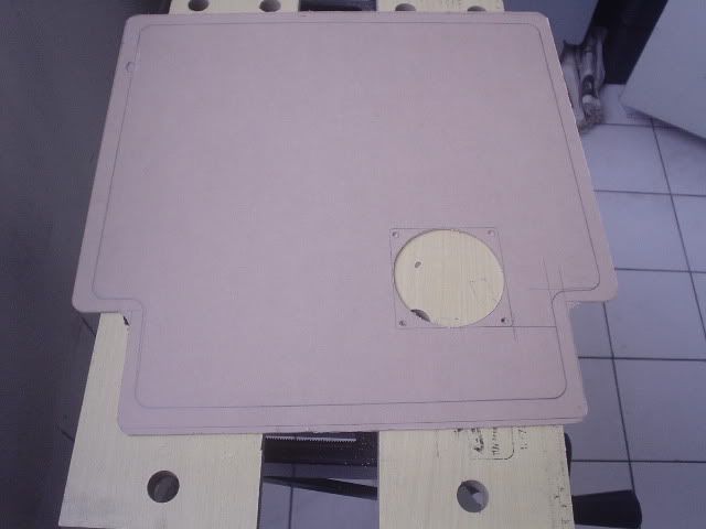

Here's the acrylic cut to shape with fanhole n holes for the fan mounting.

QUOTE(superdav007 @ Jun 9 2006, 11:32 PM)
Oooooops, sry didn't c ure post in the middle of my postings. Anyway, it's a standard sized Heavy Duty B&D cutting disc.

QUOTE(ianho @ Jun 9 2006, 11:40 PM)
that means u fix ur dremel to the table & u move the side panel to cut it?

QUOTE(superdav007 @ Jun 9 2006, 11:48 PM)
No lar. where can do lidat 1. The cutting is done by freehand method.

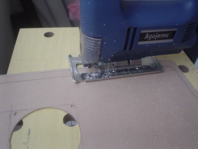

QUOTE(ianho @ Jun 10 2006, 12:00 AM)
Hehehe. 2moro will complete it. Wait for update.
if u wanna cut curves u use the dremel or jigsaw?

QUOTE(superdav007 @ Jun 10 2006, 01:06 AM)
I can do both. Depends on material of panel n also the radius of the corners.

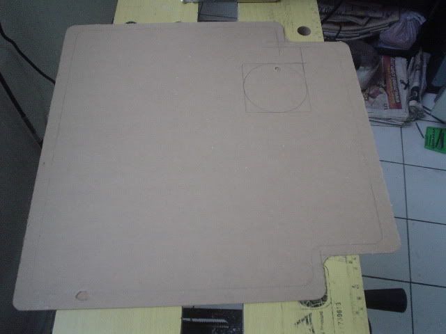

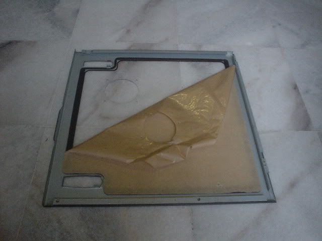

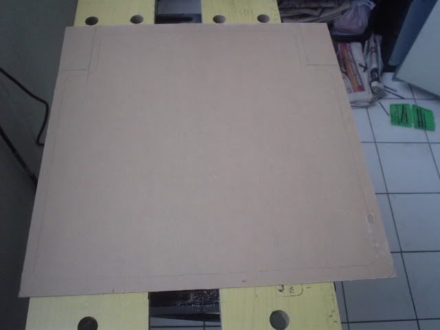

OK. Here's what I did today.
Took the rough cut acrylic n traced the exact fit that I need. Drew the lines for trimming to exact size.
Trimming the extra material off for an exact fit to make it look better though it's gonna b hidden behind the panel.

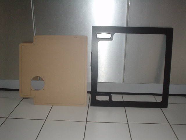

Here's the trimmed acrylic.

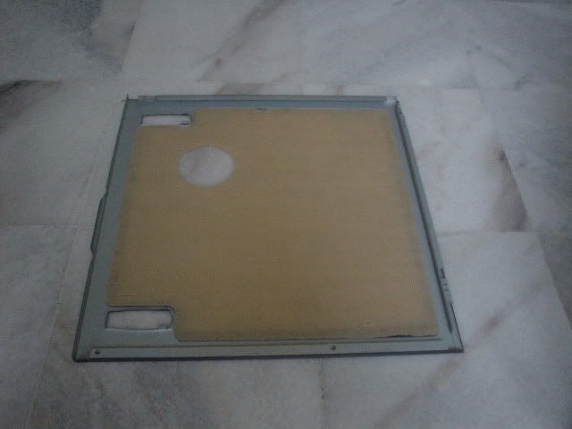

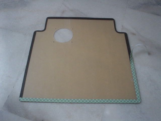

Acrylic n panel filed smoothly for perfect finish. Ready for installation of acrylic n panel locks.
Double sided tape installed. Peeling off the backing paper for installation onto panel.
Sticking the acrylic onto the panel.
Done. Now all that's left to do is to peel off the acrylic backing paper.
Now just pop the panel locks back into the holes at the top n bottom n Voila! The Thermaltake Armor Jr window mod is complete.
Here's the complete window with the fan n grill on for a test fit. The 7900GT in SLi will haf more than enuf supply of cool air now. thumbup.gif thumbup.gif thumbup.gif

Anyway, here's how the Armor Jr looks like. It's actually the same as the normal Armor, only a bit shorter.
