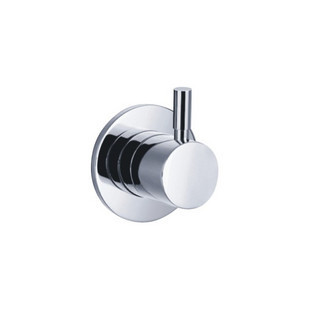

Currently the developer install something like this for the valve opening for shower rain as follows
The tap with the blue dot in the middle.
My questions is:
1. Is it that this type is most likely with piping top and bottom (in the wall)?
2. Is it possible to install something like this (from what I know this type has hot / cold water inlet)
I need to prepare myself before I get chopped...

Can't. Because it need to connect between pipe in side

Ya.. Haiz... Have to live with it... So really cannot change to mixer type even though I only need the water to run through? Coz in the end the water outlet will go the heater which I am going to install...

Found this Grohe one online, but I think it will cost me an arm and a leg... Any ideas how much it cost...

This valve destroys the overall aesthetical look of the bathroom... As I can change all the taps, except this... Argh!

i would also like to find a less ugly and more minimal tap fitting for it if price is decent.

Is actually the same, but when you tell shop about stop cock, they usually give you not so nice looking and rubber valve. The water pipe valve got more design and can can have ceramic valve which only need 1/2 turn to switch off or on.

So the best one is ceramic valve?

haha, too ex. I'm using local brand Sorento for the shower; and get a Grohe for the stopcock?!

Reliable is the rubber valve. Ceramic not so.

So does it mean that this stop cock in my bathroom (first posting) is 3/4" since it controls the valve for the water tank?
I suppose I can remove the stop cock knob cover cap (the one with blue dot in the middle) and replace with a nicer looking cover cap?

The water coming to your toilet from the water tank is call outlet. Which mostly is using 1/2" pipe. While from the meter outside to the water tank is 3/4" pipe.
The stop cock in your bathroom is to stop the water coming to the toilet tap. Since the pipe is coming from the tank and to your toilet, it is an outlet pipe. And size 1/2".
You cannot simply replace the knob. Each brand have it own design. Each brand can replace back it own brand parts. Unless those common parts. Ex. rubber washer.
Maybe those expensive type like grohe, kohler etc have an option to change the cover and knob design. But still have to using back it own brand.
So you have to hack it out and replace the whole stop cock.
