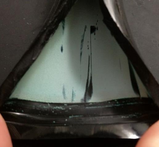

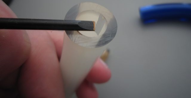

Cut your tubing in half:
Scrub it out & it should look something like this:
This post has been edited by infernoaswen: Mar 30 2013, 04:39 PM

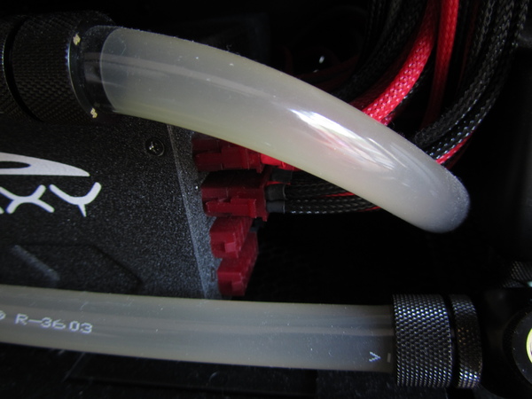

6) Okay, so what? It just clouds the tubing right so in the end of the day my system will look ugly right? That’s all?
Well sadly no. It does not only clouds the tubing, overtime it can accumulate & gunk certain parts of your system as well, your radiator, reservoir and even worst your waterblocks. While it doesn’t necessarily affect your loop temperature, it will affect your flowrate. Just imagine this, your waterblock acts as a filter with many tiny channels, when plasticizer issue becomes serious, it will start accumulating in your waterblock. With sufficient gunk accumulate at your waterblock, this can clog your waterblock channels and cause drop in flowrate. As martin posted his findings, running your loop less than 1GPM can affect your loop cooling capabilities.
Take note though, here we are talking about serious plasticizer issue that been leaching for quite sometime. The usual plasticizer lining issue that user encounter are usually very thin therefore chances of it gunking up your waterblocks or radiator is very slim. The common issue you will see is it will affect your tubing only with some whitish film in the inner surface of your tubing.

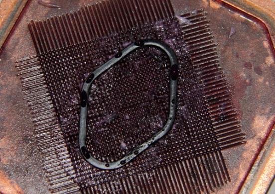

Gunk clogging your waterblock = reduces flowrate:

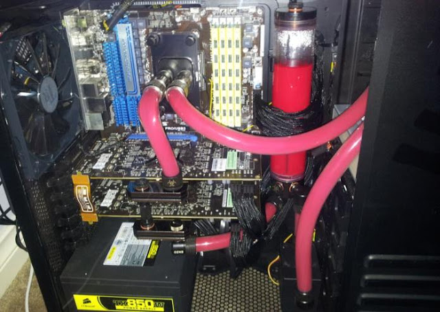

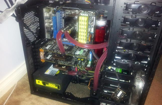

Effects of plasticizer to your loop
Before:
After:
Using mayhems pastel will not solve your problem, as the problem lies within the tubing itself & not the coolant.
Before:
After:
Notice how the coolant colour didn’t change much? This is because the inner part of the tubing is already coated with white nasty stuff but haven’t spread yet to the reservoir, running it for a LONG period of time might spread to the reservoir but it can be easily cleaned.

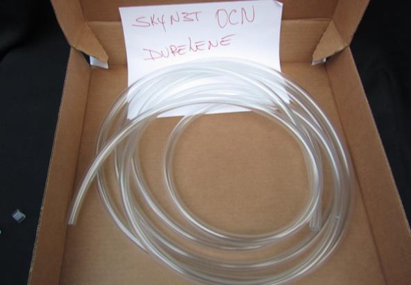

Koolance Res Crystal Clear since Day 1. Still looks clear and shiny even after the clouded tubing with Distilled water + kill coil + Mayhems Red Dye after 4 months nothing found in my blocks, rad and res:

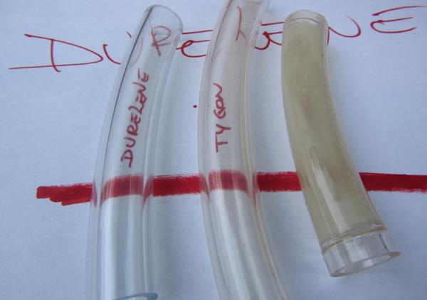

Durelene PVC tubing 7/16in. ID 5/8in. OD by Saint-Gobain First bath with Distilled warm water to clean the dust inside and ready to receive the final run. Compared with Tygon R-3603 the flexibility is not that much in real world.In my first experience with Durelene was very good, even its natural clear color is very bright compared with Tygon R-3603, Tygon R 3603 and it is kind of yellowish color.
It does looks sharp:
Here is the package i received today in the mail a Big Box with 27" of Durelene Clear tubing I already had cut all the tubing for my RiG i do have less tubing inside this box. It does look very clear no yellowish like Tygon R-3603:
Here is the comparison chart tubing. Tubing in order
1 - Durelene
2 - Tygon R-3603 ( Virgin )
3 - Tygon R-3603 after 4 months with Distilled water + kill coil + Mayhems Red Dye
Mayhems Red Dye - won't crystalize inside the Loop once is mixed it won't separate from water

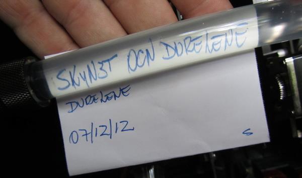

Plasticizer Problems Update.
As you guys know I'm running Durelene PVC tubing 7/16in. ID 5/8in. OD by Saint-Gobain + Distilled Water + Silver Kill Coilfor 3 weeks and 6 days ( 27 Days ) and it looks the same since Day One. not signs of Plasticize or Cloud including the Reservoir i have been running my 3570K 4.5Mhz and my GTX 670 FTW @ 1200MHz 24/7. Heat is not the issue as far as i know in my recent test's. I know i had doe some Plasticizer testing with Tygon R-3603 and Durelene in Glass Container but some how all those test when very different in what I have now both my System are running Durelene Tubing the Plasticizer Test Bench had MayHems Red Dye and still the same no Plasticizer or Cloud whatsoever. I'm very happy with my result test's.
Just to you guys know this time i have a more high quality photos compared with my last result so the pictures is much more clear look and don't pay attention in some light reflection in tubes it make it looks Blue o even a Bit Cloud But it's NOT. When water inside the tubing and some bends it's Magnify the letter's, you guys know what I'm talk about.

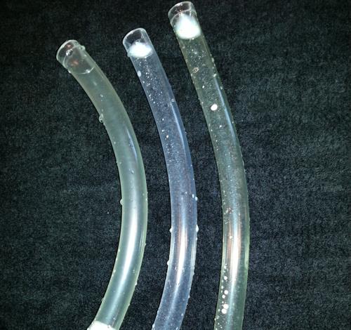

Here is the tubing since ???? and before removed and cleaned with cotton rag and a wood stick with soap.
Left tubing Durelene with plasticizer raze inside
Right New Durelene tubing
New tubing - Used tubing after had been cleaned with cotton rag and wood stick , Used tubing with Plasticizer/haze

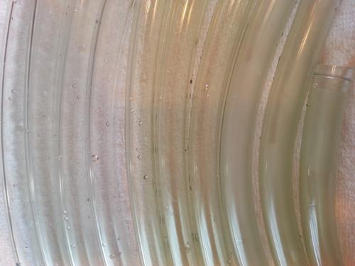

Durelene with Distilled water. Left to right
New tubing
New Used tubing after cleaned with cotton rag and a wood stick with soap.
same order, but how those tubing looks better ?
but here you can see it better but i changed the order left to right
New tubing
Over here you can see the plasticizer/haze much better but when its wet you almost cannot see it only if you put a new or a cleaned tubing side by side. Now is time to know how long Durelene toke to get like this. My tubing was changed on 7/31/12 Post #1154 http://www.overclock.net/t/1199158/plastic...0#post_17827918

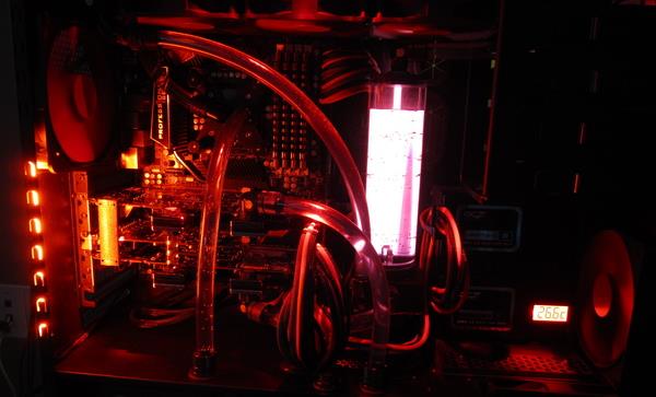

running Distilled Water with Mayhems Pastel Ice White.
PS : keep in mind my rig was running Distilled water with Mayhems Pastel Ice White, Durelene has prove the durability. even running under premix and die, the plasticizer/haze is not noticeable whem the tubing is wet. like I said above only side by side with new tubing.
Now is BHD wil only run Distilled water with Mayhems Biocide. for the next final test in very heave load.

Tests done by systemlord
I received my 2 foot long Primochill Advanced LRT Tubing (clear) today, I will leave a piece under the hot tap water all night plus soak another piece is distilled water indefinitely. I'll report by end of day today, let the abuse begin.
Updated
Here are pictures of my Primochill's new Advanced LRT, the piece on the left was put in a coffie cup while under HOT tap water for 12 hours, can you tell which of the two clear pieces spent 12 hours in distilled water? I think it's safe to say that this new tubing is more resilient than any tubing before it if my memory serves correct, 12 hours under scalding hot tap water!
Something unexpected has happened, I just looked at the piece of tubing I put through hell has for some reason lost a bit of the clouding it had earlier today! Could it be because the tubing absorbed the hot water and is now dryer now? I'm sold on this tubing, buying red as soon as possible!

Tests done by crazymofo:
Before anybody say anything, I would like to point this out. The testing method that I am using is highly inaccurate! I cannot control the variables that affects the testing procedure nor can I control the water temperatures. Unless you are kind enough to donate/borrow me some proper equipment, thermometer, heater to keep the temps at a constant temps I wont be able to do a proper test.
Now thats been said, I still try my best to give a non bias test with all the tubings. Also please take note that whatever results is shown in my test may not be the same in real life! Therefore please do not take the tests for granted.
Testing Methods:
- Used a coffee flask because it keeps heat very well therefore reduces the amount of time is needed to cool down the temps.
- I only have that thermometer and it can measure up to 44'C only.
- Because I am limited to the temps range, I decided to do two temperature test only. First test is at above 90'C & second test is at 44'C.
Durelene Tubing
Temps estimate above 90'C & tubing left in water for 12hours:
Top: Tubing after 12hours in 90'C water
Bottom: Brand new tubing
*As you can see tubing changed, some hazing is going on. At first I thought maybe its normal since temps was way to high above 90'C, most WC loop barely hits 80'C plus.
Left: Tubing after 12hours in 90'C water
Right: Brand new tubing
*This test is just to show that hazing is visible even if the tubing is filled with water.
*Its hard to see the difference in white background therefore here is some pics on black background
Temps estimate around 44'C & tubing left in water for 12hours:
Left: Tubing exposed to 90'C
Middle: Brand new
Right: Tubing @ 44'C for 12hours
*So I thought maybe tubing goes crazy at such high temps, maybe it might perform well under normal temps. After testing it @ 44'C, results seems the same. Although hazing is less compare to the first test, its still visible. The difference between both is very little to notice.
Temps @ 44'C + 2drops mayhems biocide & tubing was left in distilled for 12hours:
*Reason for biocide is to prove that the PH is not affecting the hazing problem. Plus adding biocide I believe will neutralizer the water PH, thus eliminating 1 of the possible variable.
* Just a PH test on the previous test water without the biocide. Seems like my tap water was around PH6 laugh.gif
*Tubing when its wet, yes I know when its wet the hazing seems a little less compared to dry but its still visible. Funny thing is I didn't notice this difference in the first test. Perhaps coz the temps were too high that made the tubing hazed badly? I dont know, need proper equipment & time to test why this is happening lol.
This post has been edited by infernoaswen: Apr 4 2013, 09:10 PM
TSinfernoaswen
post Mar 30 2013, 04:45 PM
3,782 posts
Joined: Aug 2010
From: subang jaya
continue from previous post
*When its dried, similar results with the 2nd test.
*This is two show the clarity of the tubing, even though hazing is apparent...we can still see through it. Not sure if this can affect the coolant colour or not though...
And now the suprising part!!
*left is the tubing I finished doing test on the water PH, the longer tubing is brand new. The two other tubing is actually tubing from previous test that I did 2days earlier. As you can see the tubing becomes clear like new once again without any cleaning or anything! I just left it on my table and suddenly when I checked it its like brand new. I just left it in my room table under a fan...
*I have two theory for this I think...
1) The tubing absorbed water and turned milky as it retains water in the tubing plastic material.
2) The tubing hazes at warm temps but becomes clear back when its cooled down.
Theory #1 might be possible, since I submerge the whole tubing in water therefore outer layer & inner layer is in contact with water. Maybe the outer layer wasn't designed to be waterproof therefore water gets absorbed in the tiny pigments on the tubing outer layer? This would explain why some users used it in their real WC rig and had no problems with it (i.e clear as new), but I check closely seems like the whole tubing material changes colour...no specific inner/outer lining that hazes. I also tried scrubbing it with few sharp tools and there wasn't any effect. If it was plasticizer I could at least remove some powder substance by scrubbing but this is not the case.
Theory #2: Another possible reason is the tubing temps, therefore I would like to do another test on the tubing. I will let it haze in warm water and once its done I will add into cold water cooling down the tubing. If there is any difference then temps could be the reason.
I will also mix it in my WC loop to see how it performs under real situation.
*retesting the tubing that turned from cloudy to clear in high temps water. Turned cloudy as expected.
*Decided to throw in a cup of ice water to cool the tubing down. Perhaps high temps caused the tubing to haze?
* Just to show you that its the tubing material that hazes and no thin lining of plasticizer forming inside the tubing.
* Clear vs hazed
Conclusion: Durelene did not plasticizer in my test. It hazes though, I would not consider hazing to be the same as plasticizer because to my understanding plasticizer = creamy cheese being formed in the tubing walls. I am not so sure myself either, I guess I will need to do more test on other tubing that is famous for plasticizer to be certain on identifying plasticizer & hazing.
I cannot gurantee durelene will not plasticizer, but based on my findings it did not. Please take note that I did the test for 12hours only therefore running it longer in your loop might give different result. Also please take note that although I report hazing in my tests, I still hear very good feedback regarding this tubing considering the price for it is very cheap. Many people that used it in their rig claim their tubing is still clear like new after installing a month or so. I will definitely add a piece of durelene tubing in my rig once its completed & will update this post on how it performed in real life setup.
This is all for now, stay tuned for tests on primoflex advance lrt & masterkleer biggrin.gif
This post has been edited by infernoaswen: Apr 4 2013, 09:24 PM

Conclusion
So I went through the whole thread and came to a conclusion and I have also summarized most of the useful info. There are few info that I decided to leave out due to the insufficient details of testing done or some evidence suggesting that particular user is the only person who is not suffering from plasticizer whereas almost all the others are reporting otherwise.
· Thread started with primoflex lrt pro having serious plasticizer issue, leaching right after 3days of use. Turning the tubing to cheesy white colour. Plasticizer issue/tubing clouding was a common problem back then with all the other tubings but it happens overtime like after few months of usage, but primochill lrt pro was pretty serious in just few days.
· A lot of feedback from other users reporting the same problem, primochill denies the problem lies within their tubing.
· Users started looking for alternative tubing brands that wouldn’t cloud the tubing, some users including martin suggested durelene.
· Few other brands were introduced, masterkleer, clearflex, xspc & tygon but there were feedback from others that they used it in the past & it clouds as well. No proper tests/evidence was provided though to back the statement up.
· More users gave good feedback on durelene as they used it in the past & it is cheap, skyn3t started doing tests on it.
· We found that durelene will have a slight haze/cloud in its tubing when it’s in the loop(barely noticeable) but once removed and dried the difference can be seen compared to new. When it’s wet, the cloud is hard to see and many other users started using durelene tubing. Received many good feedback with slight hazing to the tubing but its not a deal breaker considering the price is cheap.
· More reports from other users recommending durelene as it performs well without any hazing after few weeks of using.
· Primochill is still working on their tubing problems, they introduced sys scrubber which is some kind of chemical to add in your loop to remove the plasticizer from the tubing. Some says it worked & some said the plasticizer lining is too thick therefore the scrubber did not work properly.
· Tygon E-1000 was recommended as it’s the only “plasticizer free” tubing available in the market but the price for it is too expensive.
· Primochill primoflex advance lrt was introduced in November which was made specifically for watercooling users and were told it have addressed all the issue the previous tubing had. Some primoflex pro lrt users where sent the new tubing as a replacement. Check performancepc website, they stated the tubing to be "DEHP Free"
· Many users started using it & reported only good things about it, so far I haven’t heard any bad feedback about it regarding plasticizer issues. Many reputable forumers including mayhems himself started recommending this tubing to others.
This post has been edited by infernoaswen: Mar 30 2013, 05:20 PM

And there you have it...I created a thread with all the info that I can possibly find. Those who manage to find more info or thinks there are certain things they would like to include in the thread, feel free to let me know...will make the required changes icon_rolleyes.gif
edit: mods, if you wish to pin this thread, feel free to do so smile.gif

I'm going to change my tubing because it already shows a sign of plasticizers. Just assembled my wc kit less than 1 month doh.gif

QUOTE(Kidz1995 @ Mar 31 2013, 02:24 AM)
Good article.
Yup, decided to share it out to everyone, but dont take all the testing info seriously because its all done by normal users so it may be inaccurate.

To clean radiator is pretty much impossible because you cant open it, but what you can do is mix vinegar with water, fill & shake your reservoir for around 20-30mins & flush it out. I know vinegar is good for reservoir cleaning but I am not sure how effective it is with plasticizer problems. As for the waterblock depends on which waterblock you using, can usually disable it and clean with a toothbrush lol.
Btw just a side note, the pictures above all are for extreme serious plasticizer issues, normally plasticizer wont leach out so badly until reaching the waterblock & radiator. I still testing on durelene tubing & it changed colour at high temps but funny thing is I can't scrap it off from the inside. Its like the whole tubing clouds up... hmm.gif
