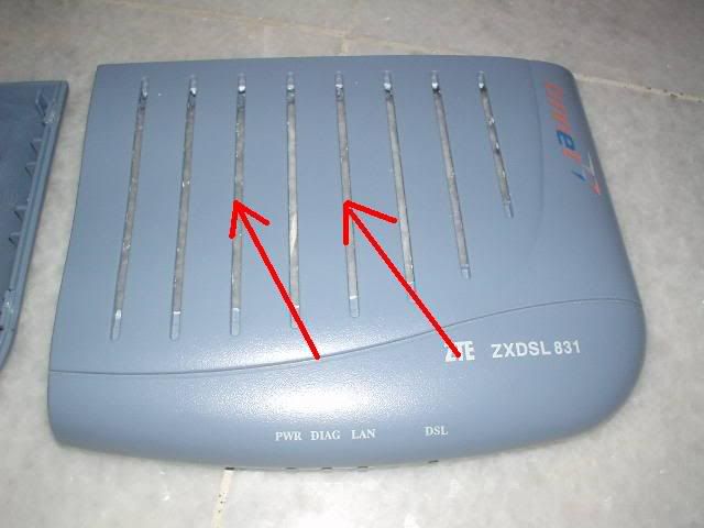

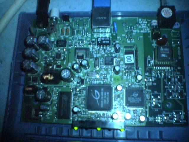

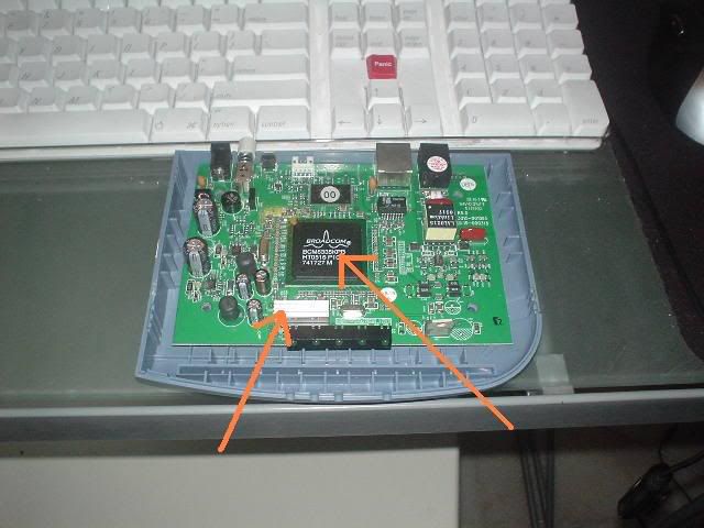

This is what I did to improve the cooling first. Those of u who haven't noticed. This silly ZTE modem runs extremely hot n I don't even use BT. Better go check ures too.

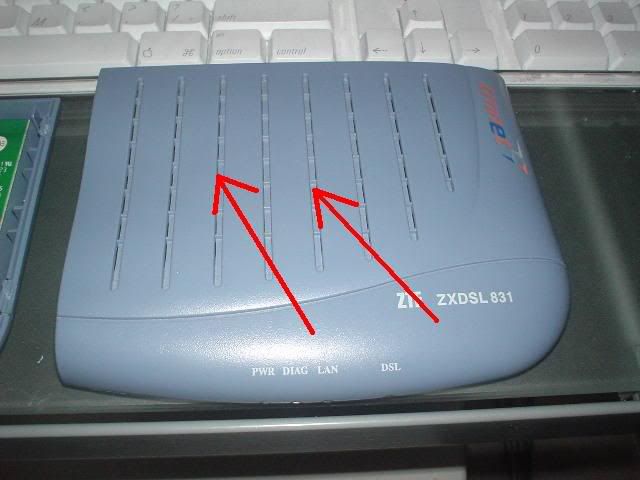

This is how the stock modem looks like. C those 2 red arrows? Stick the heatsinks there.

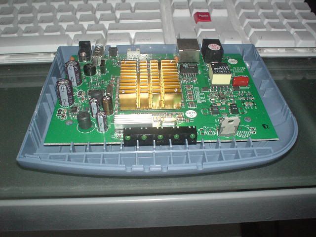

1st I stuck a CM Blue Ice northbridge cooler on it minus the fan. The smaller RAM chip, I used a CM ramsink on it.

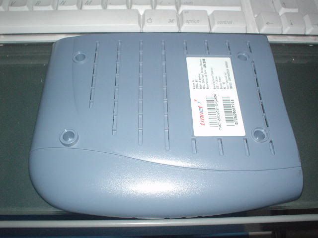

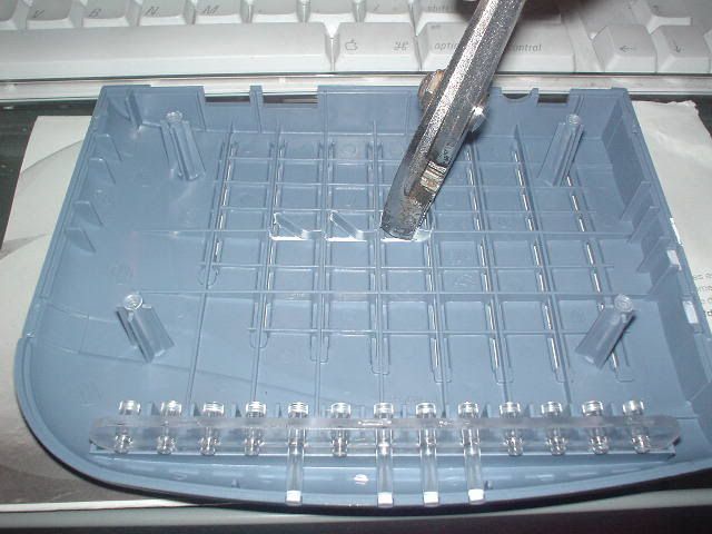

This is the standard case. Very little ventilation. Look at the arrows, it's blocked for sum reason.

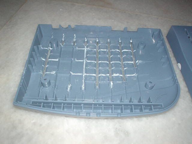

This is after I cut out the vent holes.
Same thing with the bottom. It's also blocked.

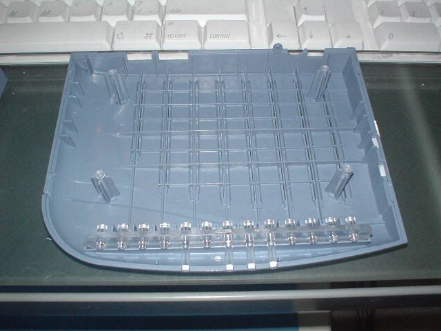

Here's what I did to open up the vent holes.

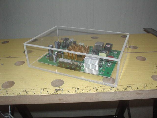

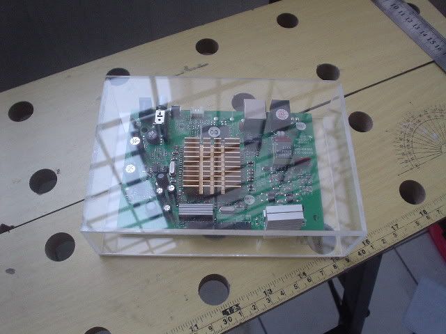

Then I tot y not make an acrylic case to gif it sum bling bling. Also, even after modding the vents on the standard grey case, it was still very very hot. So I made a big huge acrylic case for it. The back panel where the wires plug in is left out so there's plenty of ventilation.

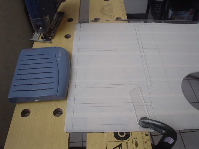

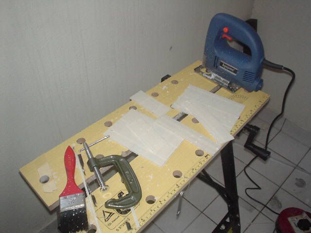

1st thing is to measure n draw out the pieces for cutting.
Next is the cutting.

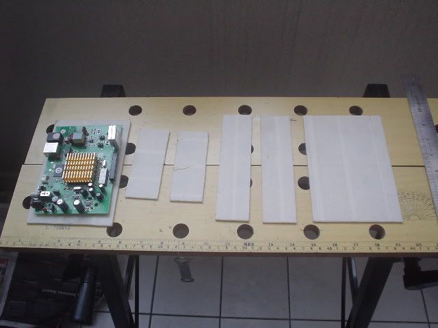

Cutting complete. Then file all pieces to exact fit so the acrylic glue can bond them together. Here's the completed pieces ready for gluing. Just remove all the masking tape n start bonding the pieces. The modem circuit board is just double side taped to the bottom piece.
I'm not too happy about the basic looking square shape of the case though it looks quite nice. I'll be making another case using a single top piece that is bent around using heatgun. It's gonna look much, much better than this. This was just a NBTD to do 15 minute mod. laugh.gif laugh.gif laugh.gif
